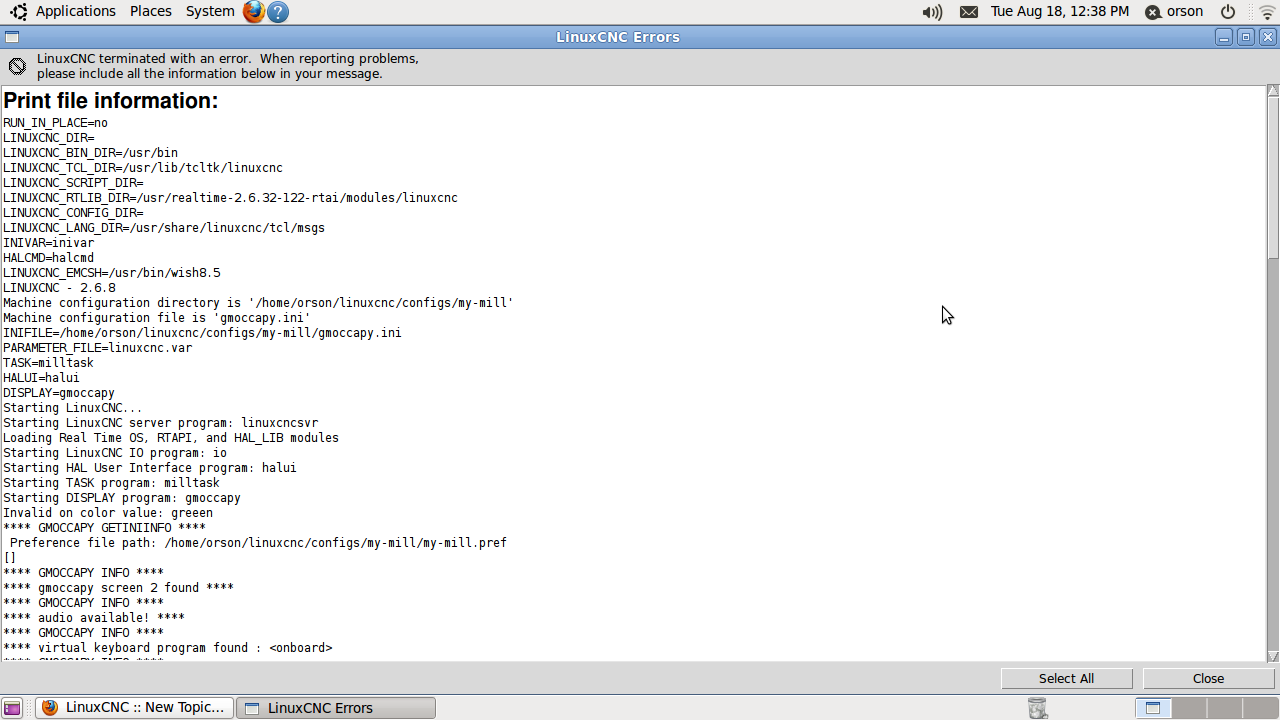

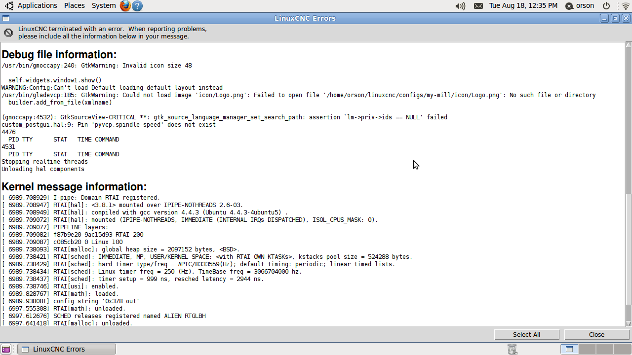

can someone help me with this error message? Or does any one have a working gmoccapy conf that they can send to me?

There is an error in your postgui hal file. Doesn't seem to have anything to do with Gmoccapy.
Btw the best way is to attach a text file of the errors or wrap them in code tags (the sheet of paper with <> on it above the smiley things) not a screen shot as there may be other errors.

any idea were to start in the postgui hal file?

in the wiki it says to copy file but does not say were to copy them from so I have been using the files from the sim config in the linuxcnc folder, could this the problem and if so were would I find the correct files?
