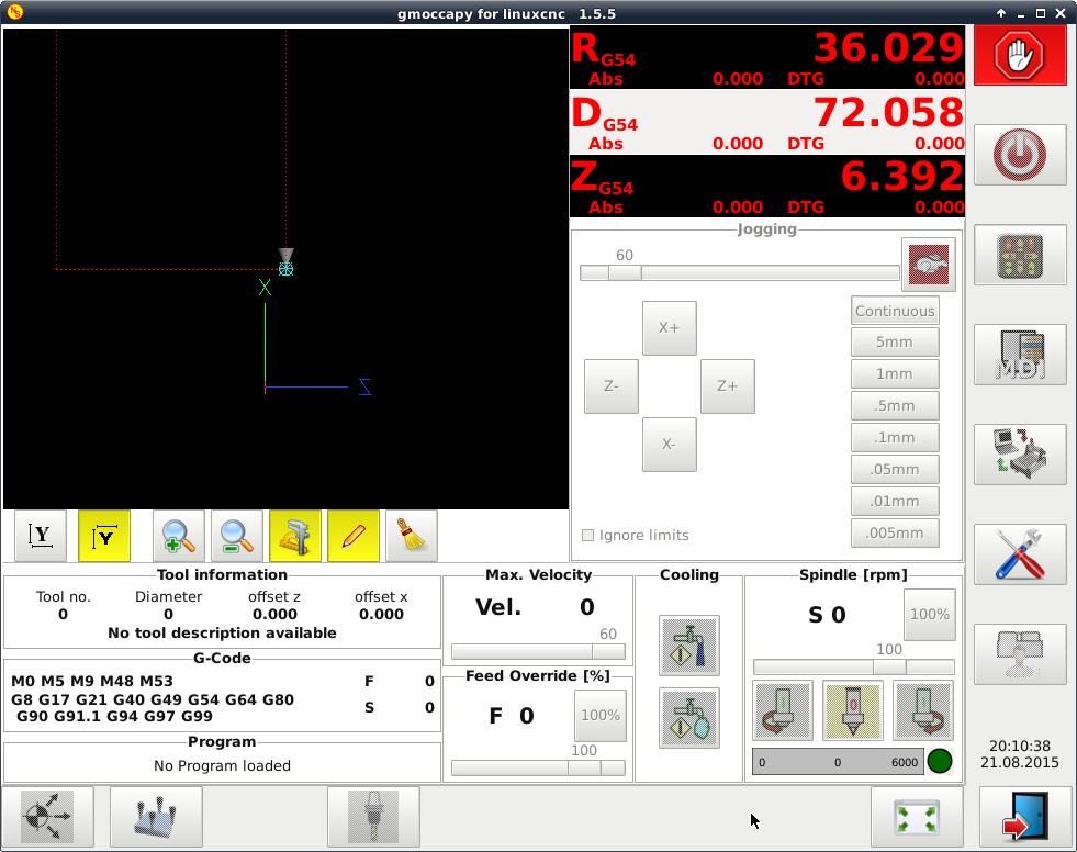

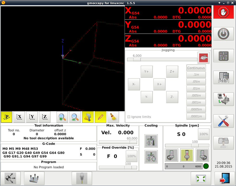

Hi
I'm trying to set the Gmocappy-display. First it look's like the first picture attached. After changing the .ini and .hal described in the tutorial, under documentation it suddently look like the second picture. I don't have the y-axis any longer....
What did I miss ?
Where can I find documentation about the Gmocappy settings ?
I've fount a .pref-file, but cannot find any changes...
SIncerly
Steen

check your .ini file
[DISPLAY]
DISPLAY = axis
EDITOR = gedit
POSITION_OFFSET = RELATIVE
POSITION_FEEDBACK = ACTUAL
MAX_FEED_OVERRIDE = 1.2
INTRO_TIME = 1
PROGRAM_PREFIX = /home/iae/emc2/nc_files
INCREMENTS = 5mm 1mm .5mm .1mm .05mm .01mm .005mm
LATHE = 1 (remove this line) Lathe Mode
X-Y-Z DRO - Mill Mode
R-D-Z DRO - Lathe Mode
