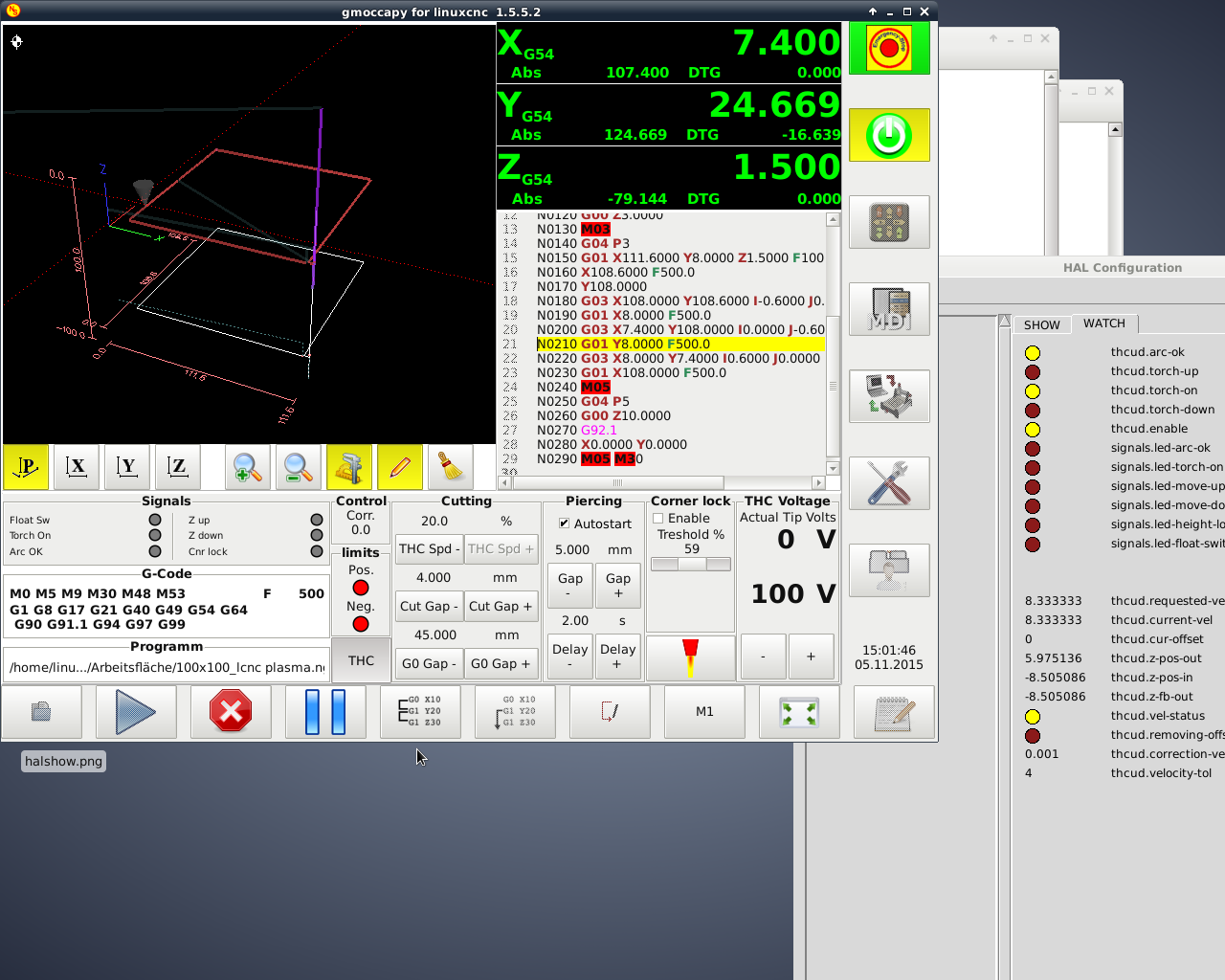

yes you are right, it was to high for this i changed to 5 and now to 0.001. Now the value is changing very smooth so the stepper should be able to follow it. Bit it didn't.
heres a picture again. Im a little bit wondering about cur-offset is not changing. Afaik should it change to the value the stepper is moving through thcud, or not?
and iḿ not sure about this line
i think this is the problem, but dont find how to hook it correctly
YES: i got it
now z-axis is moving
Marius, big thanks for your patience, can you short tell me how to hook your signals, that the leds in the screen are working?
net thc-pos-fb thcud.z-fb-out => stepgen.2.position-cmd axis.2.motor-pos-fbi think this is the problem, but dont find how to hook it correctly
YES: i got it
net thc-pos-out thcud.z-pos-out => stepgen.2.position-cmd
net thc-pos-fb axis.2.motor-pos-fb <= thcud.z-fb-outnow z-axis is moving

Replied by mariusl on topic Is someone using Gmoccapy Plasma ?
I am pleased that you got going.
These are the signals involved in the signals panel
net MoveDown => signals.led_MoveDown ---> to your net for "DOWN" from the Proma
net MoveUp => signals.led_MoveUp ----> to your net for "UP" from the Proma
net FloatSwitch => signals.led_FloatSwitch ---> from the probe-in net
net ArcOK => signals.led_ArcOK ---> from the arc_ok pin from the THCUD component
net TorchOn => signals.led_TorchOn ---> from the net that turns your torch on and off
net HeightLock => signals.led_HeightLock ---> you will not use as it is for the software THC solution
When you are done with the implementation you can have a look at doing your own component to handle the corner lock problems. Read a bit on that on the wiki and then I will help you setup the corner lock feature.
Shortly, it looks at the requested velocity and when the torch has decelerated to below a certain preset percentage of the requested velocity, it will stop the THC function. It will restore the function when the speed is again above the corner lock threshold.
You will need this to counter act the corner dive behaviour of the THC.
P.S. Not all the signals and controls provided on the plasma screen are used by all systems. They are all the possible options that one could need to do a very comprehensive THC system but not needed for most.

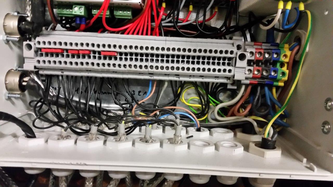

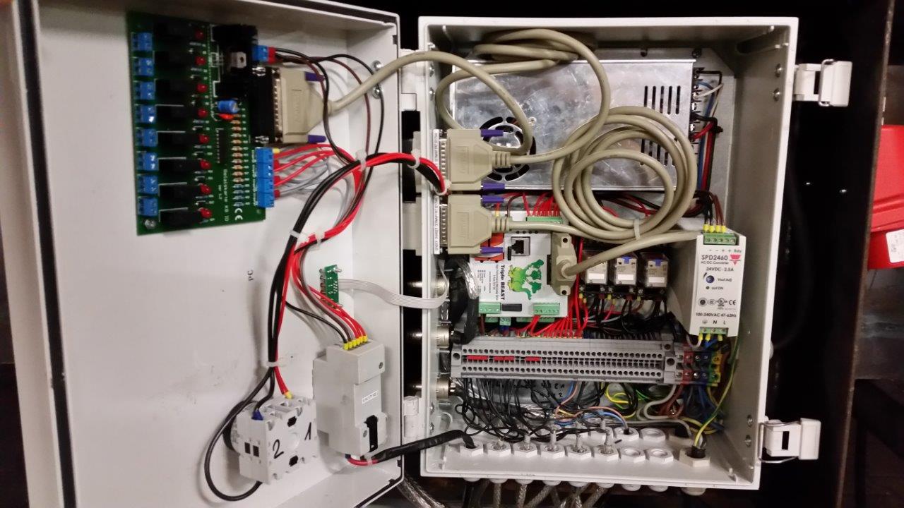

now under testing i got a problem that the triple beast from benezan causes sometimes an External E-Stop when firing up the torch.
at the moment iḿ not sure how to get it done and where the problem is
maybe you have an idea with your experience?
Aah so now the fun of plasma starts
You have noise on your system. With plasma I use screened wires on all items including the motors. You have to have a common earth point on the controller side only.
The source must be correctly earthed as well.
1) What breakout board do you have?
2) What make and model plasma do you have?
3) How did you wire the emergency and float switches?
4) Are the limit switch wires screened and earthed on controller side

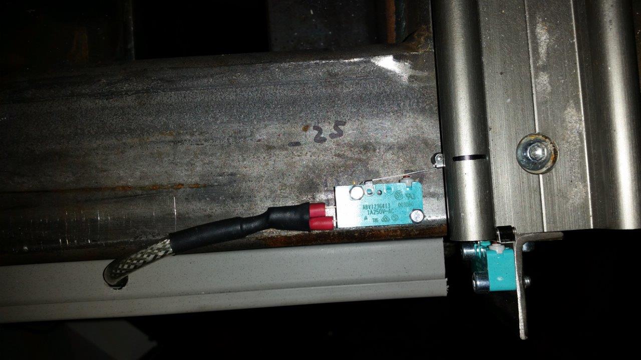

Replied by Michael80 on topic Is someone using Gmoccapy Plasma ?
i thought about the noises in system.
1) Triple Beast from Benezan benezan-electronics.de/shop/product_info...ath=8&products_id=61
2) Stahlwerk PCut 120S www.stahlwerk-schweissgeraete.de/de/shop...eider-cut-120-s.html
3) so what do you mean with how did u wire? (see pic ref-switch, float switch)
4) screend yes, earthed not (wiring 1+2) but wires are long enough to put all screens to earth
All those screens must be connected together at one common earth point at the box end. That will be a good start. Make sure that all power is earthed at the same point
By the way, your box look great and well built.

Replied by cncbasher on topic Is someone using Gmoccapy Plasma ?
you'll find adding a debounce component to all your switches will help .
ook, so i need more space in my panel
but it looks a good idea, but it will delay the e-stop if it is pressed
- Posts: 19896
- Thank you received: 4648
06 Nov 2015 19:17 #64885
Not by enough to matter. How long does it take you to press the e-stop? Another 2mS is neither here nor there.
Replied by andypugh on topic Is someone using Gmoccapy Plasma ?
