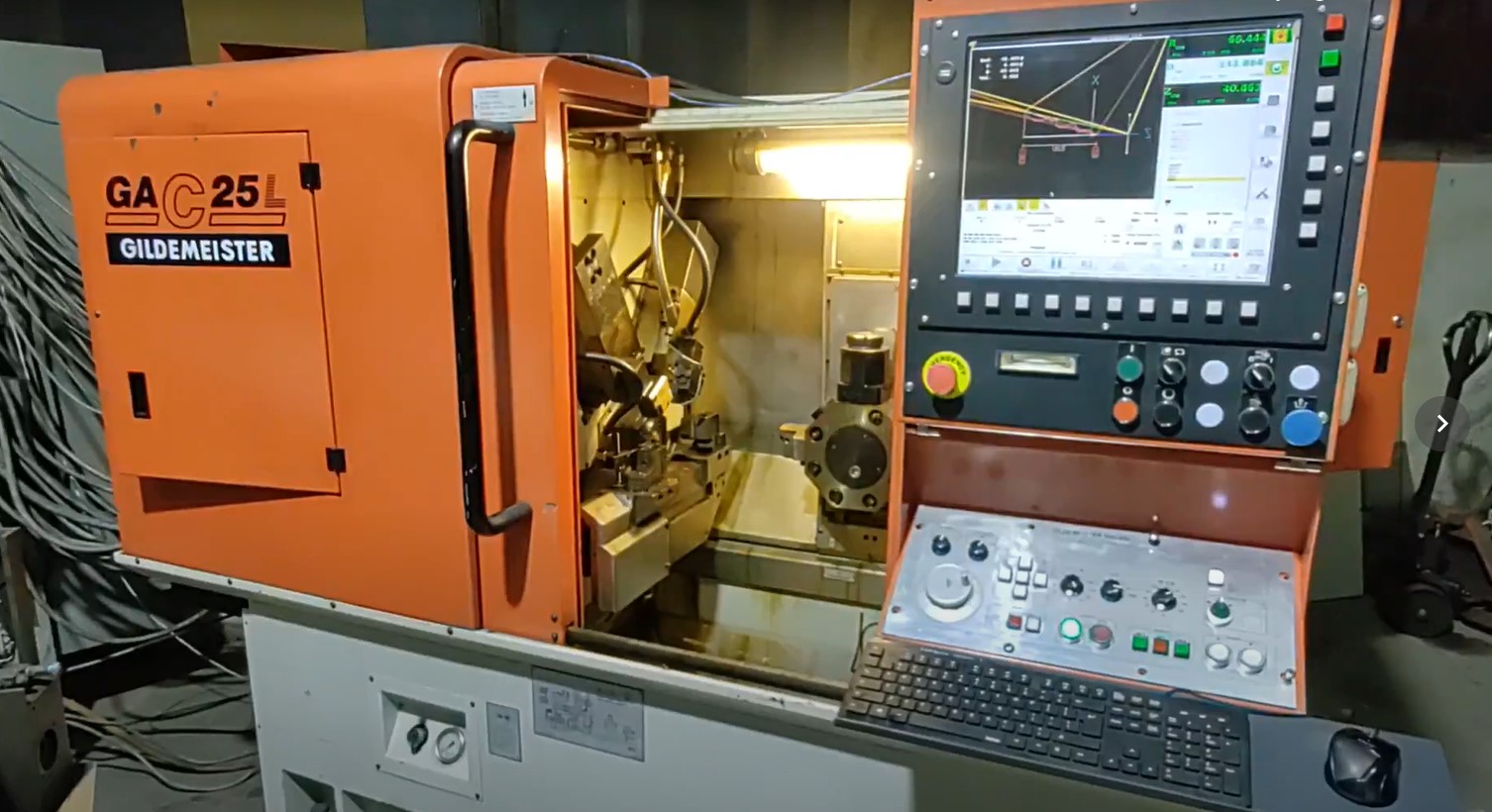

Hello,
i work on retrofit of X-Z + Y axis lathe (swiss type lathe). Y axis i parallel with Z axis and moves the hydraulic chuck (lünette function).
I use 2.7.15 with gmoccapy. I setted up the Y axis positioning, i can use axis, but when i jog the Y axis, it can jog over software limits, and hit the end switch.
In MDI i CAN'T send Y over softlim, i get alarm and moving is not executed.
Jog button is controlled by halui.jog.1.minus /plus signals.
There is a connection between that gmoccapy not supports Y axis, and jogging axis over softlimit?
X and Z axis jogging works ok.

Y-axis can not be parallel with Z axis!
Parallel to Z can be a W axis.
If you can jog over the limits and hit that way the end switch, your himing or limit is not set correct. Do you home the related axis prior to jogging?
Gmoccapy should support XZCW config. May be you should not set Lathe = 1 in your INI.
Norbert
Norbert

Hello,
thanks for quick answer. I set LATHE = 0; and then the Y jogging is correct (that means min_limit / max_limit / homing setup is correct). The axis is stops on softlimit, and i cant jog over them (niether with button, or MPG).
It seems to be something if LATHE = 1. What you think if I set W axis instead of Y, something changed?
I dont know this side of linuxcnc source code. I checked a gmoccapy.py file, what happens if LATHE=1, i found swapping / removing jog buttons / DRO etc.
If I modify this file, to activate Y axis jogging buttons, maybe change something?
Or some other file? (i use halui.jog.1.minus / plus pins)
Just need to Y jog works like on LATHE=0 mode.
In program mode, when executing G code, the soft limit is working on Y axis. (show error messages if i program axis over softlimit).
It is little complicated 4 channel lathe. And would be good to use Y axis for moving the chuck.
Video
photos.app.goo.gl/Thk3apEb6d1hLz1aA
