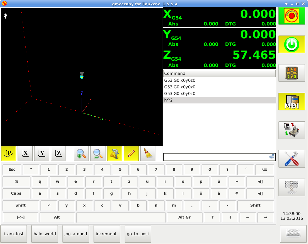

I have a touchscreen interface that I'm using with gmoccapy. The documentation says that it works with two keyboard programs, matchbox-keyboard and onboard. Neither was installed on my Debian 8 installation, so I loaded matchbox-keyboard. I can now get the on screen keyboard from the terminal window, but not in gmoccapy.
In gmoccapy, when I go into the MIDI window and touch the keyboard icon, it blanks out the bottom of the screen, but no keyboard. How can I get it to work?

I replaced Debian 8 with Debian 7 (long story, see my other posts), and the touchscreen keyboard is now working.
The letters on matchbox-keyboard are tiny and hard to see and I'd like to try Onboard. It's packaged for Ubuntu, and have not had any luck installing it on Debian 7. I've read some older posts on this topic, but installation of the various components give errors. Has anyone had any luck installing Onboard on Debian?

Why are the matchbox-keyboard buttons so tiny?
Do you have a screenshot?
I also tried to get onboard to work on debian, but also without success.

@10k
sorry for the delay,
I made some tests and the best I could find is to modify the layout.
I made one for a German keyboard.
To test please make a dir .matchbox in your home directory
Place the attached file in there and rename it to keyboard.xml
start your config and check if that would be better.
Norbert

Could you please try to change the global font settings of your window manager?
Mine is set to SANS 10, if I set it to SANS 12, the fonts of the keyboard do get larger.
