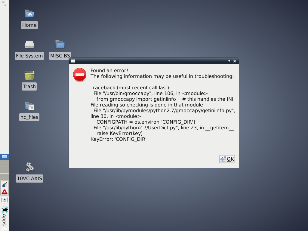

Startup Error

You get this error on starting the PC?
What have you added to autostart?
The error should not appear, it says that the variable ConfigPath is not initialized.
The start of linuxcnc does that, not the PC start.
Norbert
