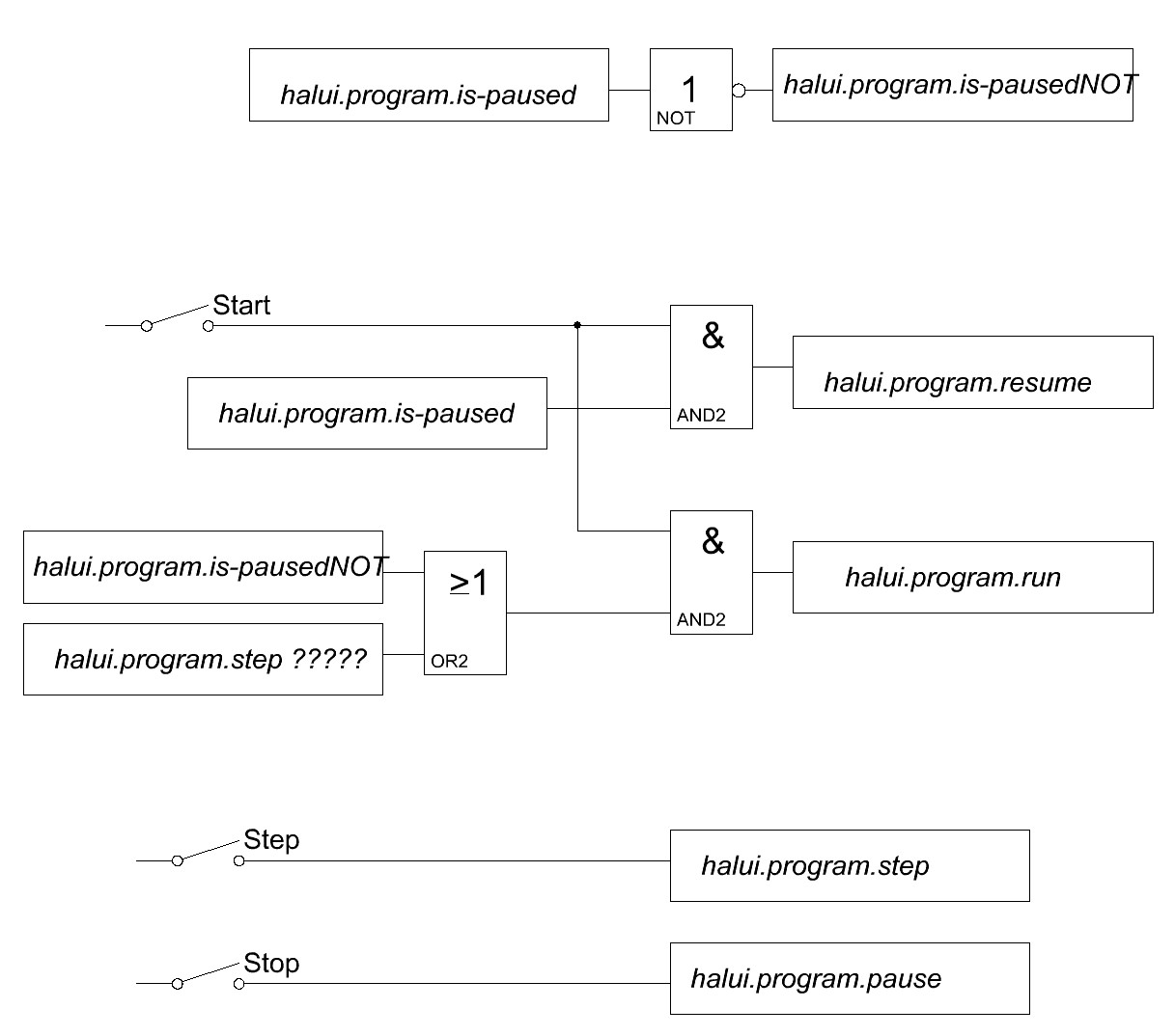

This is a hal question, not a gmoccapy related one, you should ask in that section.
@Admin: Please move to corresponding section.

Here I found some answers to my questions
forum.linuxcnc.org/forum/47-hal-examples...-hold-resume-buttons
