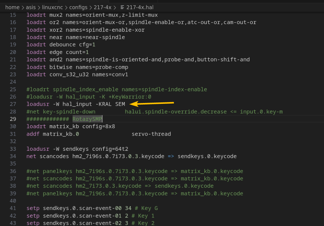

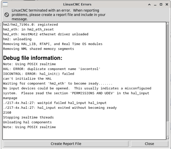

Hi ,
I try use : loadusr -W hal_input -K +KeyWarrior:0
in my hall, but debug file pop-up
Note: Using POSIX realtime
HAL: ERROR: duplicate component name 'iocontrol'
IOCONTROL: ERROR: hal_init() failed
can't initialize the HAL
Waiting for component 'hm2_eth' to become ready.....................
No input devices could be opened. This usually indicates a misconfigured
system. Please read the section 'PERMISSIONS AND UDEV' in the hal_input
manpage
./217-4x.hal:26: waitpid failed hal_input hal_input
./217-4x.hal:26: hal_input exited without becoming ready
1233
Stopping realtime threads
Unloading hal components
hal_input <<
how to access permission. ?
or more other file to setup before use ?
FYI:
in hall line 26 is : loadusr -W hal_input -K +KeyWarrior:0
Thank you,
Asis

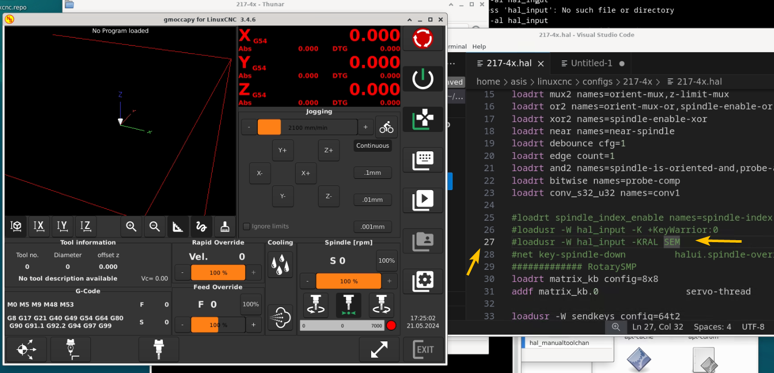

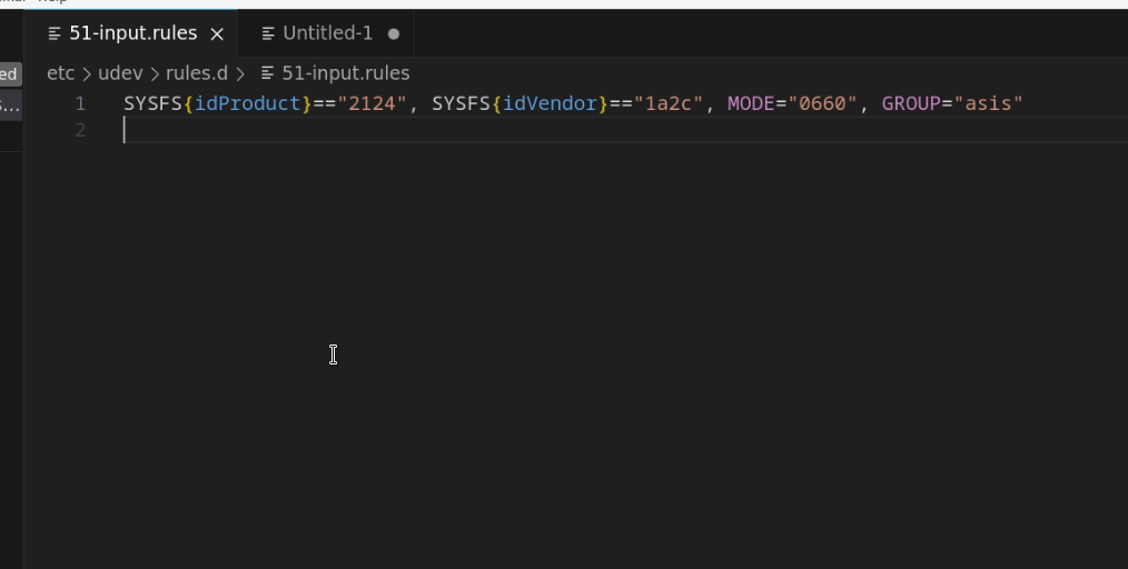

21 May 2024 06:09 - 21 May 2024 07:09 #301054
by abdulasis12
Replied by abdulasis12 on topic Keyboard Shortcuts in Gmoccapy
Thank you for reply MR. HansU
I try with your link of MR.andypugh .
I: Bus=0003 Vendor=1a2c Product=2124 Version=0110
N: Name="SEM USB Keyboard"
P: Phys=usb-0000:00:14.0-4/input0
S: Sysfs=/devices/pci0000:00/0000:00:14.0/usb2/2-4/2-4:1.0/0003:1A2C:2124.0001/input/input5
U: Uniq= H: Handlers=sysrq kbd leds event5
B: PROP=0 B: EV=120013
B: KEY=1000000000007 ff800000000007ff febeffdff3cfffff fffffffffffffffe
B: MSC=10 B: LED=7
I create file on /etc/udev/rules.d/
ATTR{idProduct}=="1a2c", ATTR{idVendor}=="2124", MODE="0660", GROUP="asis" #(I already create group name: asis )
I save, and reboot 1 time
When run linuxcnc , not work , just :hal:27: hal_input exited without becoming ready
Have any more for me set-up ?
Thankyou,
Asis

21 May 2024 07:16 #301058
Replied by Aciera on topic Keyboard Shortcuts in Gmoccapy
Not sure if this is related but you seem to have a preceding error:
if you comment out the line
loadusr -W hal_input -KRAL SEM
Do you still get the 'iocontrol' error?

27 May 2024 17:55 - 27 May 2024 18:27 #301609
by Talla
Replied by Talla on topic Keyboard Shortcuts in Gmoccapy
Hi
i test this on my Machine and i think your UDEV is wrong.
My Inputdevice:
I: Bus=0003 Vendor=04b3 Product=3025 Version=0110
N: Name="LITE-ON Technology USB NetVista Full Width Keyboard."
Add this to your UDEV File ---- change the id´s to yours.
ATTRS{idVendor}=="04b3", ATTRS{idProduct}=="3025", GROUP="plugdev" ,MODE="0666"
Then open a Terminal make the following commands... with your naming
sudo adduser cnc plugdev
sudo udevadm trigger
halrun
loadusr -W hal_input -KRAL LITE
after that i get this
note: name is 'LITE-ON Technology USB NetVista Full Width Keyboard.'
halcmd: Note: Using POSIX realtime
I get no more permission warnings.
Here a Video from my testing today.....
youtu.be/aqY-ZunRbHU
Peter
