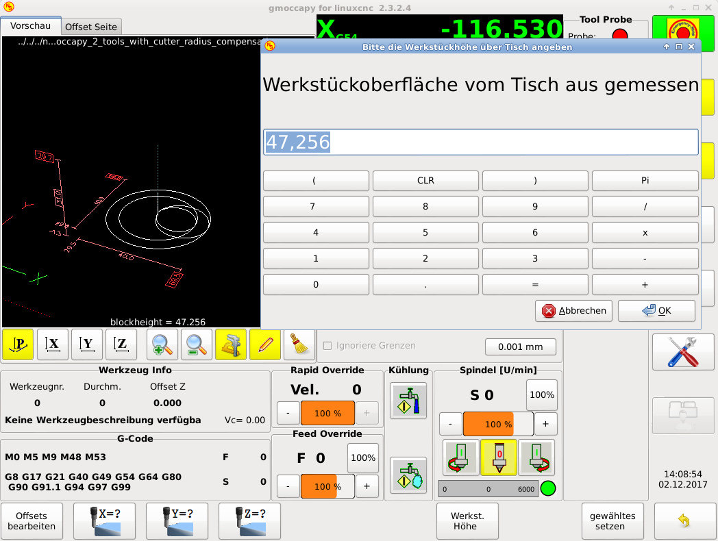

02 Dec 2017 13:20 - 02 Dec 2017 13:21 #102595
by newbynobi
Replied by newbynobi on topic GMoccapy Block Height display
Hallo crisiacuf,
hallo Rubenv,
I just pushed gmoccapy 2.3.3, to solve the problem.
I changed the following:
- the block-height value will be saved in the preference file each time it change.
- if the checkbox "use auto tool measurement" on the settings page is active, a new
label on the bottom of gremlin preview will be visible, showing the actual value.
- the hal pin block-height will be set on start up to the value, saved in the preference file
Does this solve your problems?
Norbert
