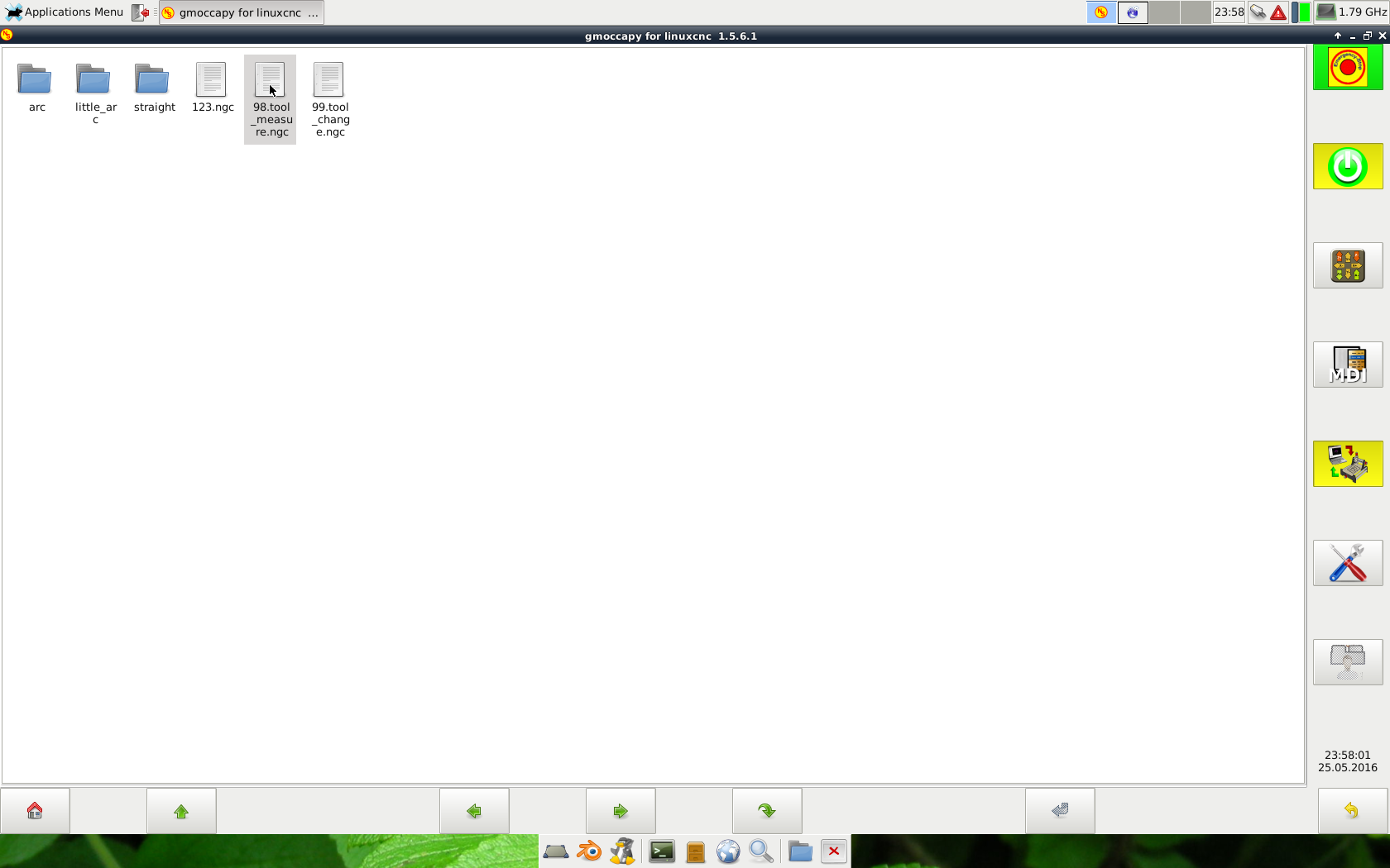

Two questions.
1. How configure gmoccapy file explorer to open directories/files with single touch? It's not very convenient to do double touch on my touch screen. Single touch is much more faster and simple.
2. As can be seen on attached picture, cursor hovered and clicked on *.ngc file but blue arrow button (located below) seems isn't active. I think it's a file-open button, but why it's disabled? The only way to open file is to make a double touch on this file.
Thanks.

25 May 2016 21:31 #75085 by andypugh
Replied by andypugh on topic Issue with gmoccapy file explorer
This might not be a specific Gmoccapy thing.
Try opening a file-manager window, then Edit->preferences and in "Behaviour" select Single-click to activate a file.

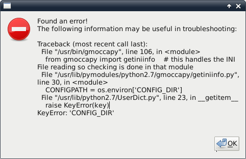

26 May 2016 14:25 - 26 May 2016 14:58 #75116 by tarasko
Replied by tarasko on topic Issue with gmoccapy file explorer
I tried, no success.
I don't how it can be related to the current question. Maybe there is. I have also an error each OS reboot.

27 May 2016 09:55 #75143 by newbynobi
Replied by newbynobi on topic Issue with gmoccapy file explorer
That is not possible, as a selection chaneg will also happen if you do use keyboard arrows, I am not able to handle the difference at the moment.
That Issue has been solved 30.03.2016, but unfortunately the pakages have not been updated yet.
You can replace the existing file on your PC
/usr/share/pyshared/gladevcp/iconview.py
with the attached one (please rename from iconview.txt to iconview.py, you may need root access to do that.
You will solve with that also a second bug, "double clicking in a white space will give an error".
Norbert
