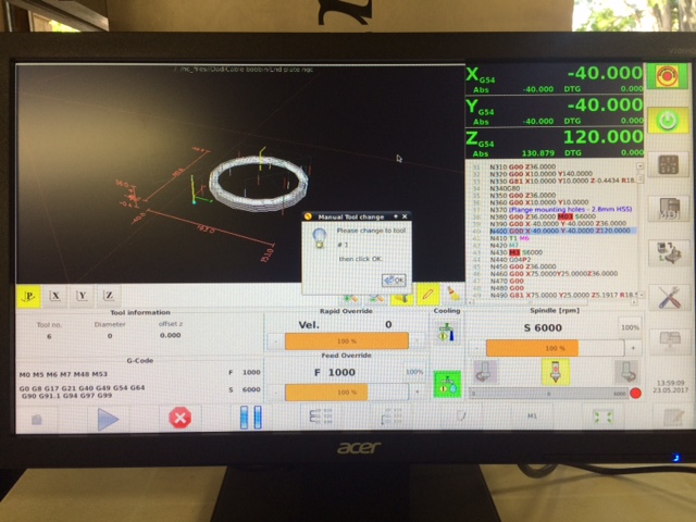

It is not possible to reduce the size lower than 750 pixel, as that would include to rezize all widgets. A lot of coding.
If you use full screen all should fit.
If you have a problem with tool change confirmation, you are using hal-manual toolchange, instead of the gmoccapy one.
just comment out everything with hal_manual_toolchange and add the following lines to your postgui hal file
See also linuxcnc.org/docs/html/gui/gmoccapy.html#_tool_related_pin
net tool-change gmoccapy.toolchange-change <= iocontrol.0.tool-change
net tool-changed gmoccapy.toolchange-changed <= iocontrol.0.tool-changed
net tool-prep-number gmoccapy.toolchange-number <= iocontrol.0.tool-prep-number
net tool-prep-loop iocontrol.0.tool-prepare <= iocontrol.0.tool-preparedNorbert

Following online documentation, downloading the required macro and python files from Master, and adapting .ini and .hal files as required, the Gmoccapy manual tool change prompt appears as expected.
However, the crucial requirement to perform manual jogging and touch-off after tool change is not met, since Gmoccapy manual/mdi control is inhibited while the tool change prompt is in focus (see attached image), irrespective of choice of full-screen, maximised or floating window.
Is it in fact possible to perform manual / mdi functions via the Gmoccapy GUI while awaiting confirmation of tool change? Is something overlooked or incorrect in attached .ini &, .hal files?

It is not possible to jog or do MDI commands, during a tool change!
If you want to do that, you need to look at the "moveoff" hal component.
I do not know why you want to do such think.
I have the remap procedur move my machine up, then to a tool change position and after changing the tool it moves back to the previous XY coordinates.

We find that a 50mm Z-setter clock gauge placed anywhere on the 2,75x1,83m supawood machine table (on steel base structure) is the most convenient means of setting Z as tools are changed on our gantry router, which has used Axis GUI for a number of years.
'Moveoff' and 'external offsets' branch of LCNC will be examined for alternatives to use with Gmoccapy.

I wonder if automatic tool-length probing would be a solution for you? It is reasonably straightforward to remap the tool-change process to automatically take the tool to a permanently-mounted probe, measure the tool, and then continue accordingly.

The suggestion of permanently mounted probe may be the way to proceed, if constraining machine use by the requirement to move to a fixed probe point, avoiding the danger of spindle traversing from work in progress over another job (or material in preparation) in order to probe - an infrequent scenario, although the large table lends itself to such.
It's anticipated that a single tool table can be used, provided that a custom fixture has associated coordinate system z-origin offset. Is this the direction of suggested investigation (having only briefly reviewed the suggested external-offsets github branch)?
Pointers to good examples of 'moveoff' or similar applications which move the spindle to fixed (G53) x-y coordinates of a probe following manual tool change, and return to G54 (or other) workpiece coordinates will be helpful.

Look at the sample configs, specifically sim->axis->remap->manual-toolchange-with-tool-length-switch
(You should be able to start and run if from the config picker, it won't try to move hardware, so feel free to experiment)
