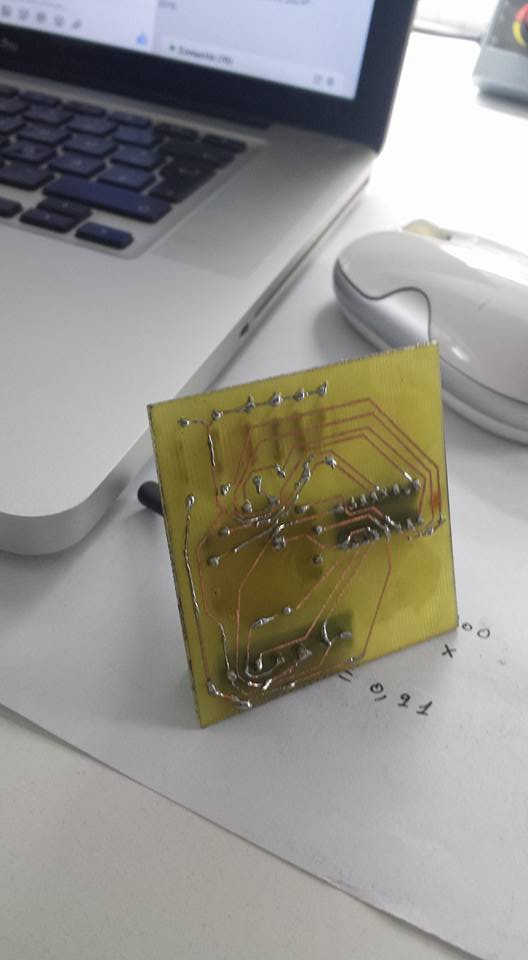

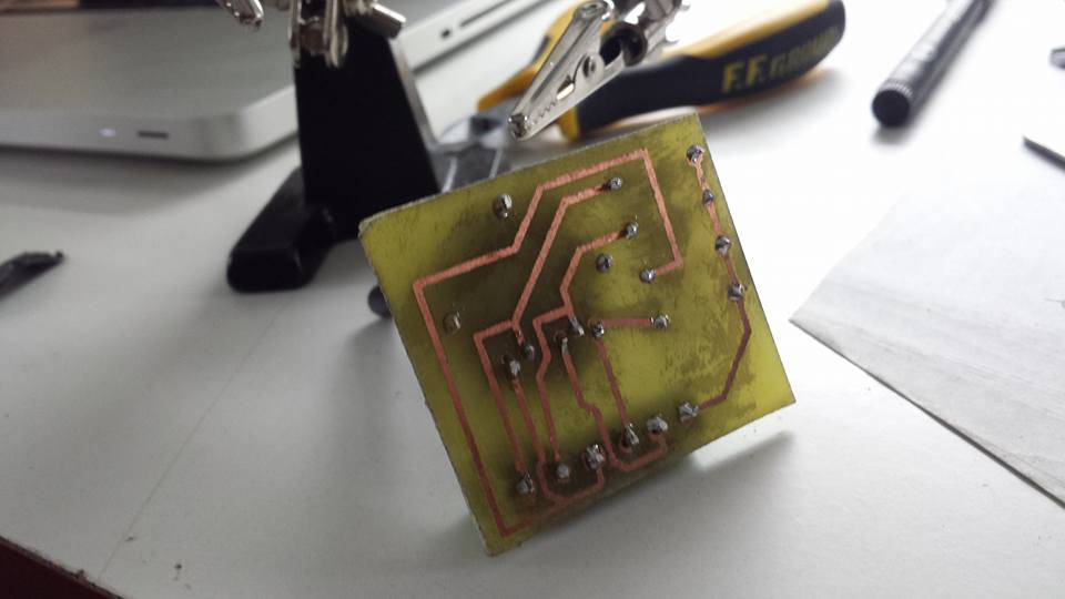

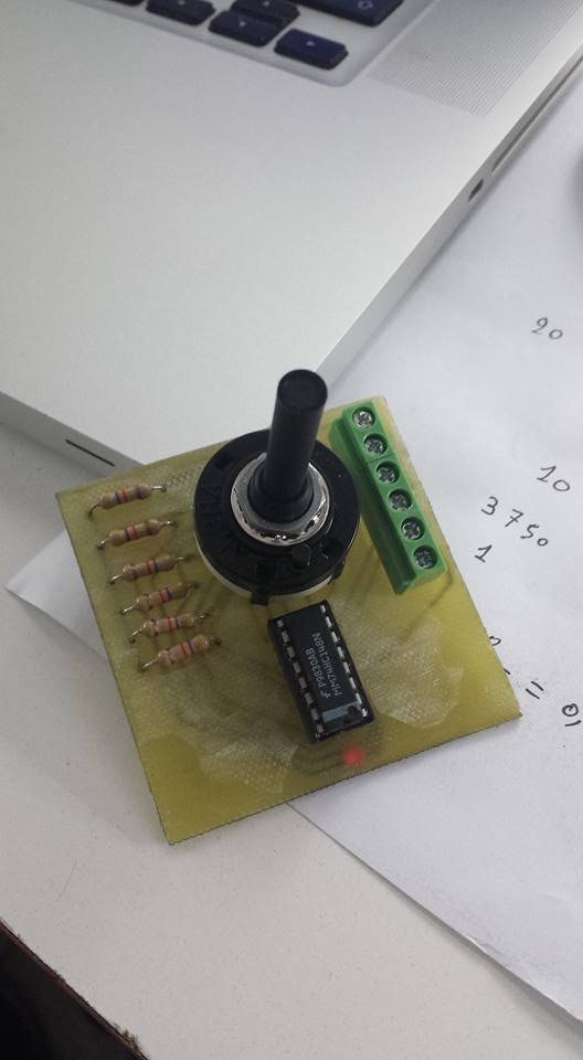

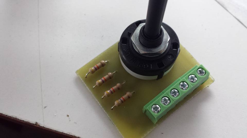

I am building a plasma for my university. I have made so far :
a thc with arduino, an encoder and a 1.8 tft screen
3 rotary switches. One 16 position (lorlin BCK1004) four output for feed override. One 6 position with 3 output(with a MM74HC148N binary encoder). One 16 position (lorlin BCK1004) four output for the mode switch. For the last one i have written a hal component to encode this four outputs to 16 hal pins(each time only one is true). I have intentions to make this mode switch like a fanuc mode switch. more on that later

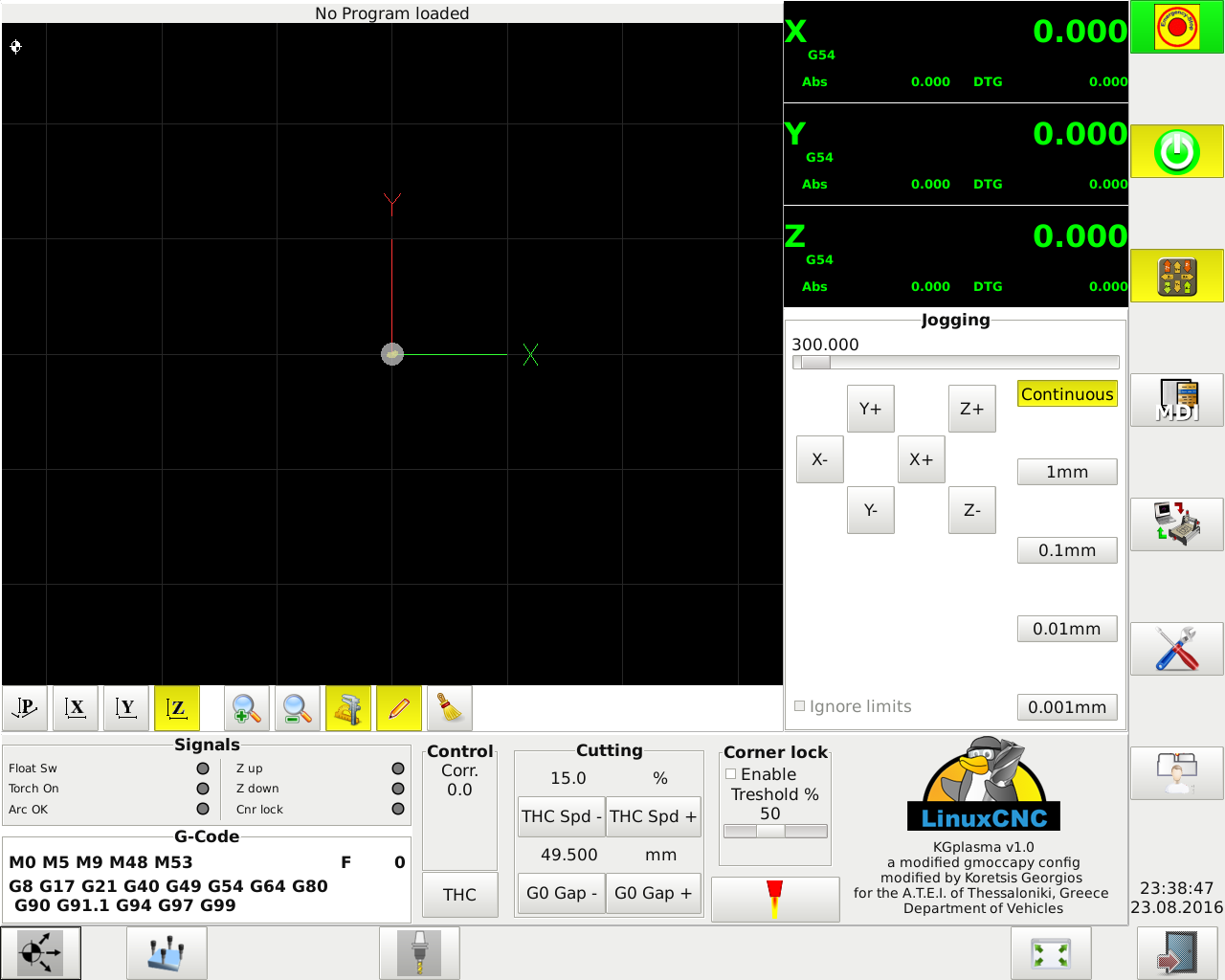

tweaked the gmoccapy interface to get rid of the unwanted buttons and reorder some things.
Now i am trying to make a user tab that is showing the g code quick reference for the operator. I am not a programmer and python seems very difficult for me so my approach is to find the offline html documents of linuxcnc so i can embed a browser in the user tab. Help is welcomed !

I have made the gladevcp for the reference. You can download it from the link below. One think that must be done is to change the highlighting of the text founded from the search. Now it is not so clearly visible. I dont know how to do it. If someone can help me i would be gratefoul.
you need to change the python file to edit the paths for the html's folder location.
Now i must make a gladevcp that reads the sim.var file. looks for parameters 100-1100 and reads their values. In the panel i will have a table with 3 colums. One colum the description (this will be a separate file ) one columm will be the number of the parameter and one colum will be the value of the parameter. I think i will take the offsetpage glade and modify it to my needs. We will see. I am not a programmer at all...
Thank you for your help.

The second gladevcp user tab is ready !
I have done it by my own because the default offset widget has too many things i dont need. I took parts of the offsetcode and made my own.
You can find and test it here. Rename parameters.txt to parameters.py. Embeded in gmoccapy with
in the ini file. Place this 3 files except the sim.var in your config directory. You need to have your sim.var file in this directory too and you need to add the lines starting from 100 to 1100 like the sim.var provided. Dont replace the sim.var file unless you know what you are doing. Only edit or replace sim.var file when linuxcnc is not running.
Thank you.
EMBED_TAB_NAME = Parameters
EMBED_TAB_LOCATION = ntb_user_tabs
EMBED_TAB_COMMAND = gladevcp -x {XID} -u parameters.py parameters.gladein the ini file. Place this 3 files except the sim.var in your config directory. You need to have your sim.var file in this directory too and you need to add the lines starting from 100 to 1100 like the sim.var provided. Dont replace the sim.var file unless you know what you are doing. Only edit or replace sim.var file when linuxcnc is not running.
Thank you.
