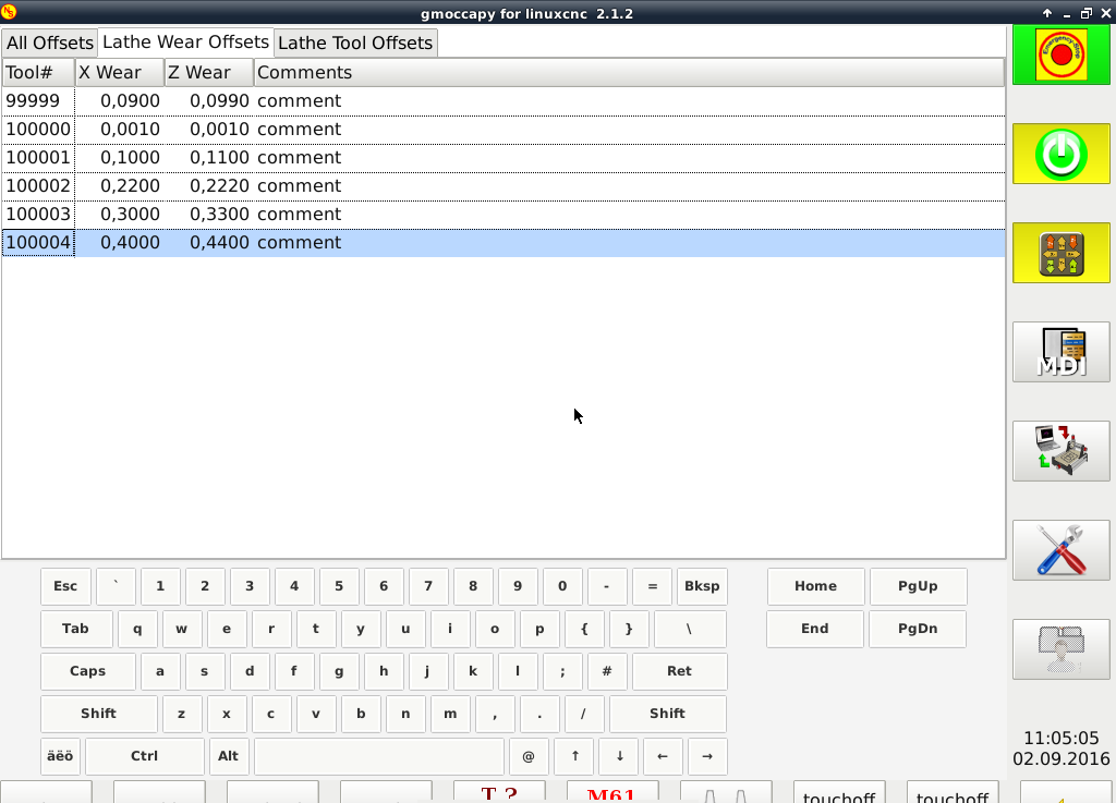

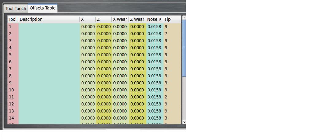

The tool editor widget you see there is made to display wear offsets according to Fanuc standards.
a tool number >= 10000 is a wear offset.
But to use wear offsets requires you to use remap code to redirect tool changes to add wear offsets properly.
There is a sample config that uses shows one way to remap this way.
look for sim/axis/lathe_fanucy
According to the readme
T0101 would load tool 1, load tool offsets for tool 1 and add wear offsets of tool 10001
T0201 would load tool 1, load tool offset for tool 1 and add waer offset for tool 10002
Which I believe is backwards from most Fanuc but can be changed.
you also don't need to add m6 or G43/g43.2 commands

Thinking about it, I guess you don't actually need to use remap.
T1 m6 g43 h1
g43.2 h10001
would be the same as T0101 (tool one, wear offset one)
Chris M
T1 m6 g43 h1
g43.2 h10001
Chris M

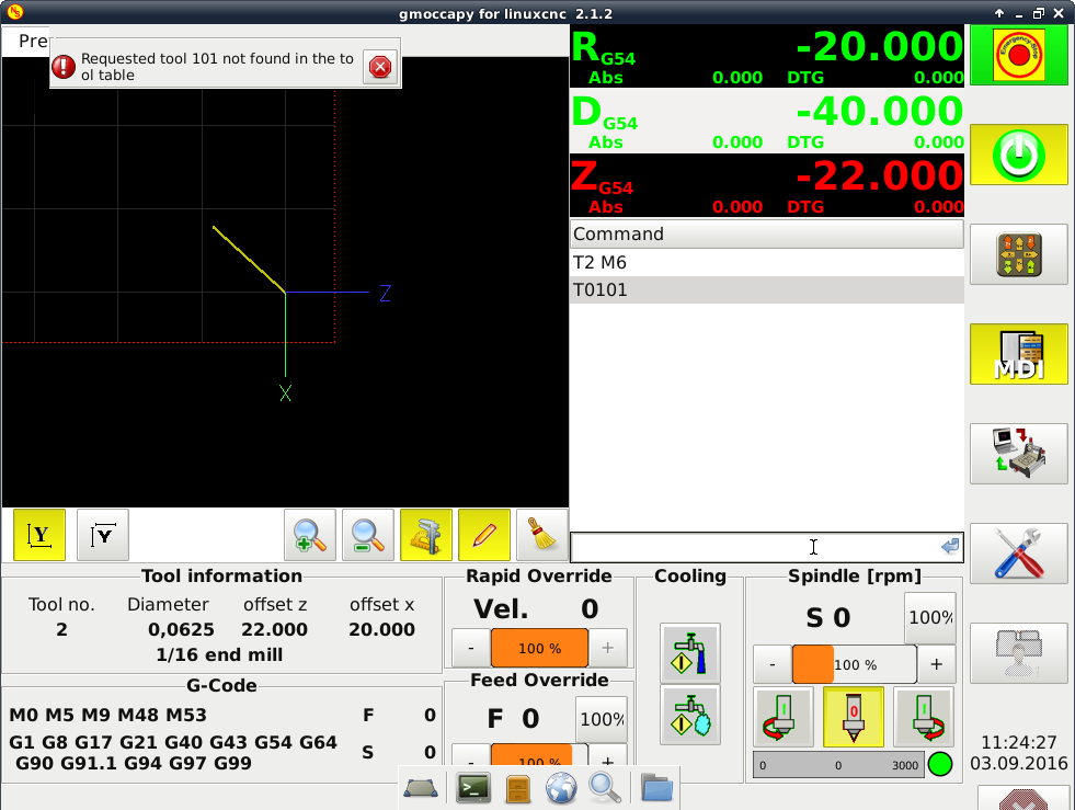

Command T2 M6 --- OK
Command T0101 ---Error
Version 2.8 .0-pre1 , maybe not yet implemented tool wear ?
or I have to complement hal ??
Replied by dinkata on topic X wear Z wear inTooltable gmoccapy
I'm not sure what you mean.
What doesn't work?

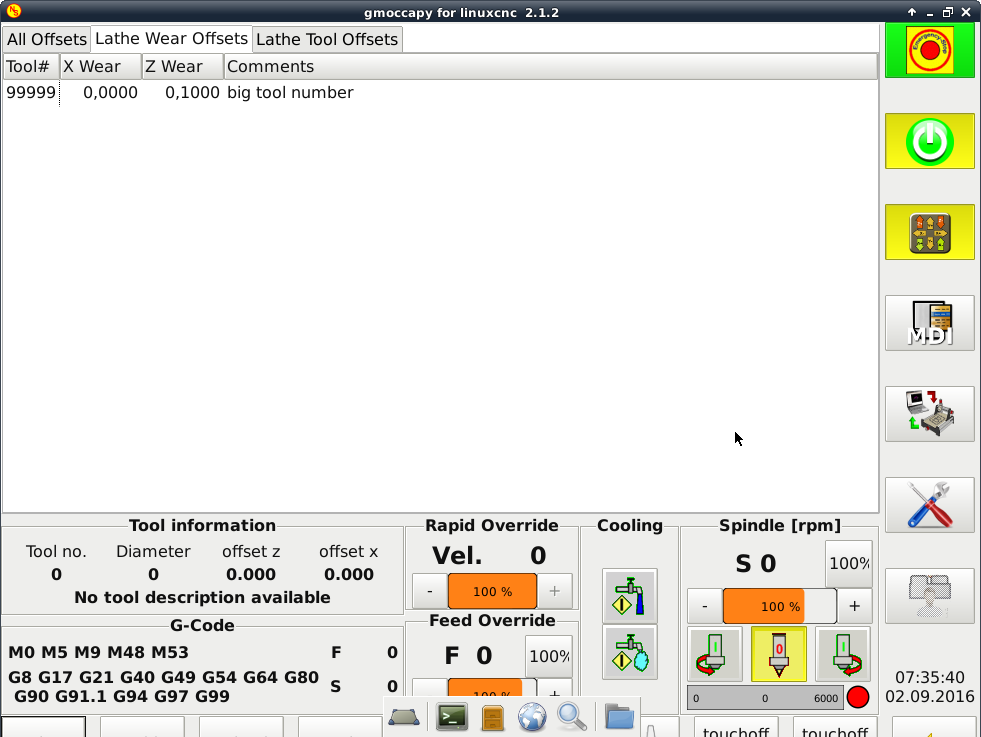

I have not even noted, that this widget has been changed to display also wear offsets!
The documentation is here
It says, that remapping is required.
I think I should include a INI entry to hide that part, otherwise most users will be disturbed by unneeded tabs and entries.
I just pushed 2.1.4 hidding that additional tabs as default.
If you wish to use wear offsets, add to
if someone (dinkata, it is up to you
) does a documentation I can include, it may be visible as default.

03 Sep 2016 14:24 #79975
As I stated:
To use T0101 as the command to use wear offsets requires you to use remap programming.
Doing it directly with G43.2 will always work.
Chris M
Replied by cmorley on topic X wear Z wear inTooltable gmoccapy
What doesn't work?
As I stated:
Chris M
