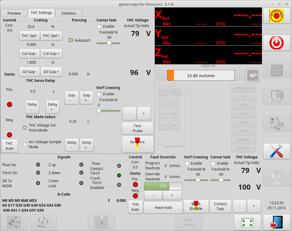

Hello
I am trying to modify the Gmoccapy plasma gui to support my custom desires. I have very limited understanding of object oriented programming and Python in particular. I have had some luck with adding a user tab that doesn't actually do anything, I'm stuck on the Python part. I have modified the signals tab (signals.glade and signals.hal) to add more leds with mixed success ( still quite shaky on directions for HAL pins). I am also puzzled by the fact that the most reliable modifications are when I change connections in the plasma.hal file and not the signals.hal file.I have modified the plasma tab (plasma.glade, plasma.py and plasma.hal) with mixed success. I have tried modifying the plasma.py file but even seemingly minor changes cause it to not work. Is there a special compiler I need to use for this file? The biggest success so far is getting the arc voltage as measured with the THCad card to display as the actual plasma voltage.
I am also trying to find the base Glade files that build the stock Gmoccapy screen so I can follow parts of it as examples but can't find it. I want to have a feed override frame on my main plasma screen and want to use the one from Gmoccapy if I can find it. Where should I look for them?
John
John

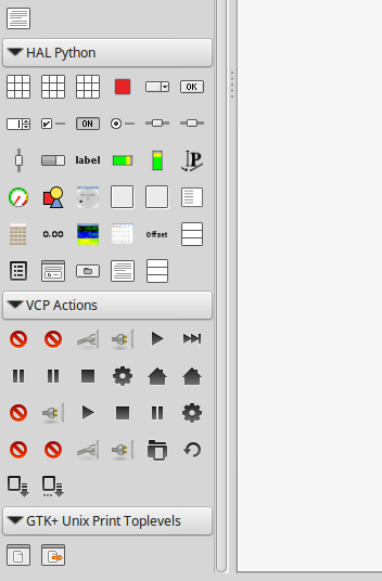

Thank you. I have used the Glade editor. I haven't been able to start it from the terminal but right clicking on the file from the file browser and selecting edit with Glade works. I am running LMDE-2 and using lcnc 2.8.0 pre. I down loaded and built Glade 3.5.8 several months ago following instructions I found on the forum.
I have been able to do simple changes to the signals.glade and plasma.hal files to get simple leds connected to signals and Glade hal-button wiget objects for action. I am still not sure why I get better (higher percentage of working after fewest trys) by using the plasma.hal file for the connect vs using the signals.hal file. I will post all files some time in the next few days when I get a little more done.

Does your own-build Glade include the specific LinuxCNC widgets?

I am not sure if my build of Glade contains the LinuxCNC widgets. I do get the HAL widgets in a pane on the left side and they do work. This could be the reason I can't find the speed control widget. A correction I am actually using Glade 3.8.5 as recommended on in other forum posts
John
John
29 Nov 2016 20:39 #83453
Replied by andypugh on topic GUI Modification Plasma
If you have the HAL widgets then they should work (for simple things like LEDs)

I am embedding tabs into Gmoccapy as I understand the instructions in the documentation. I started with the plasma version of Gmoccapy and followed what was done there. I have attached screen shots of my present progress. Notes:

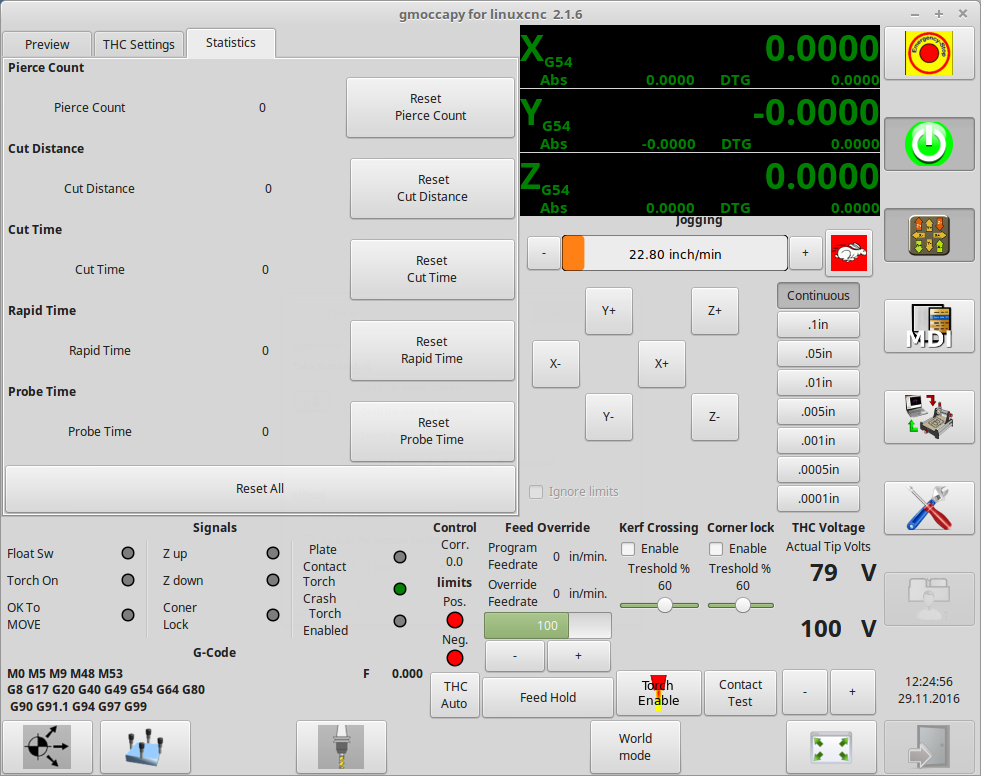

1. Statistics tab is just a screen, no underlying HAL or Python code to support it. I have found JT's timer posts and hope to expand on the code in those.
2. The THC Settings tab works partially. The widgets that used the original plasma_tab.py ( this is simply a copy of plasma.py) code work. All attempts to add support for new functions/widgets have failed.
3. The plasma section in the main screen is now partially broken. The arc voltage fron the THCad does still work but the buttons for controlling the set point don't work. Again all attempts by me to alter the Python file (plasma.py) have failed.
4. Most LEDs with HAL connections work. Some LEDs and buttons with external I/O with HAL connections work. I know there is hope because I can toggle relays from the GUI and see field signals displayed in some cases.
John

I have removed the extra tabs from the GUI for the present work and will add them later. I found a mistake I made in a variable name and now I can update the voltage set point. I also found where code I removed was preventing the persistent label values from being updated on shut down. I have been copying as close as I can the work done by others on the plasma screen because I certainly don't know what is needed to make the GUI and HAL work and what is not. The Python part is becoming a little clearer but is still mostly black magic to me. My .ini file adds the tabs I want exactly as shown in the Gmoccapy plasma example. Ultimately I want control and display of persistent variables in more than one tab from any tab they are visible in, I am sure this is not a trivial matter.
I now think that I have adding LEDs and buttons then linking them through the HAL to hardware mostly under control.
I still can't find the SpeedControl widget when using the Glade editor, is it possible to add it editing the Glade file with a text editor? The best solution is if someone can point me to instructions for adding it. I am using Glade 3.8.5 and think that I have most of the other HAL widgets.
I have had no luck using the gladevcp -c switch in the EMBED_TAB_COMMAND = line in the .ini file. That switch causes my tabs not to load (or at least not show on the GUI) .
John
