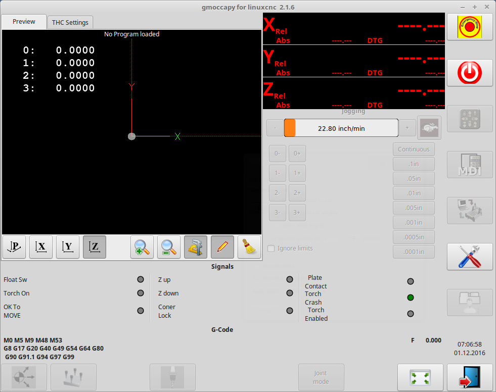

Things were doing going well until I tried to add a feed override control to one of the tabs will the plasma.glade file and plasma.py file. Now I get a funny screen, it looks like the plasma.glade file doesn't load at all, see screen shot. Other things I noticed;
1. The other tab expands to take the space of the plasma.glade tab.
2. The plasma.py file doesn't run correctly, no plasma.pyc file or plasma.var file created.
John

Please start your config from a terminal. You will be able to see the output / error that prevent the tab to load.
Norbert

01 Dec 2016 22:03 - 01 Dec 2016 22:08 #83542 by newbynobi
Replied by newbynobi on topic GUI Modification Plasma
Hallo John,
Very clear:-)
Traceback (most recent call last): File "/usr/bin/gladevcp", line 309, in <module> main() File "/usr/bin/gladevcp", line 210, in main
handlers = load_handlers(opts.usermod,halcomp,builder,opts.useropts) File "/usr/bin/gladevcp", line 111, in load_handlers
mod = __import__(basename) File "./plasma.py", line 110
self.target_voltage = hal_glib.GPin(halcomp.newpin("Target-Voltage-Main", hal.HAL_FLOAT, hal.HAL_OUT))
IndentationError: unexpected indent
Just correct that!
It is a typical python error, please use only spaces, mot tabs to ident!
Norbert
