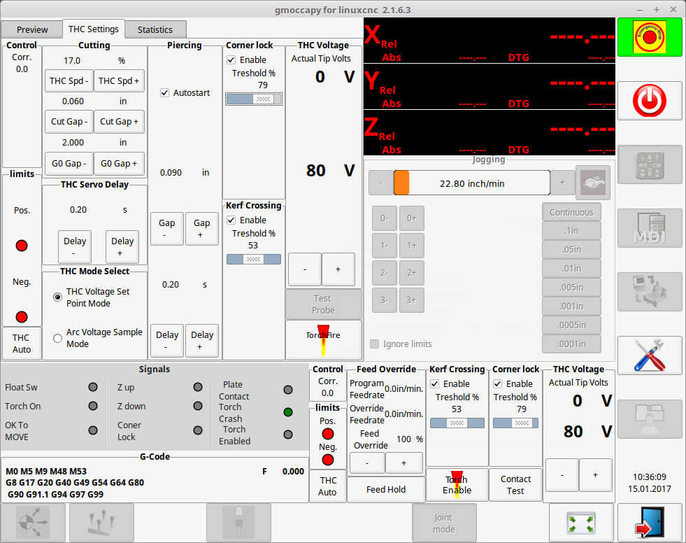

Plasma component in Gmoccapy was created by rodw
Guys,
I'm using a mesa 7i76e and a THCAD-10 card
I just moved my config from axis GUI to gmoccapy which was surprisingly painless
Well that is until I tried to connect my THC pins to gmoccapy
The plasma sim has this line
so I assumed all I needed to do was change it to
The system then complains that plasma.hal_lbl_cur_volt does not exist. The plasma component is loaded when i Look in halshow so I'm not really sure what I've done wrong. Any help would be appreciated.
net curvolt plasma.Target-Voltage => plasma.hal-lbl-cur-voltso I assumed all I needed to do was change it to
net curvolt thc.volts => plasma.hal_lbl_cur_voltThe system then complains that plasma.hal_lbl_cur_volt does not exist. The plasma component is loaded when i Look in halshow so I'm not really sure what I've done wrong. Any help would be appreciated.

15 Jan 2017 12:43 #85813
by newbynobi
Replied by newbynobi on topic Plasma component in Gmoccapy
Hallo rodw,
I am pretty sure, that you do load the mentioned line in a normal hal file.
As the plasma stuff are just different embedded tabs, you have to put that line in hal file, that is loaded with the embedded tab.
The tab is loaded as follows:
In your case the mentioned line need to be in the plasma.hal file.
The reason is, that the embedded tabs are loaded after the GUI is displayed, so the hal pin are not available at earlier time, that after loading the embedded tab.

15 Jan 2017 17:58 #85832
by islander261
Replied by islander261 on topic Plasma component in Gmoccapy
rodw
You have used different names for the pins. Underscores are not the same as dashes. I do this all the time because I type so poorly.
John
John

15 Jan 2017 20:22 #85847
Norbert, thanks, I think this is my problem. I copied my .hal and .ini files over from another config into a fresh plasma sim config and went to town on them. My Ini file is still pointing at plasma.hal, not the .ini file I am editing. Thanks a lot!
I've got all the THC signals tested and working except for the interface to the GUI which I'm just starting on. Once I get that done, I want to try a few things in the THC component.

19 Jan 2017 11:05 #86139
Replied by rodw on topic Plasma component in Gmoccapy - BUG REPORT
Well, I've resolved this error. Its a bug in Gmocappy plasma sim and Islander spotted it earlier, so thanks John! Also thanks to the tip to run from the command line
This line was generated when I created a brand new sim from the LInuxcnc chooser.
A gmocappy plasma sim generates this plasma.hal file that uses underscores (_) where it should be using hyphens. (-)
Now if I had chosen any other signal, the bug would not have bitten.
So to wrap this up, can somebody confirm that building my config in plasma.hal is best practice?
