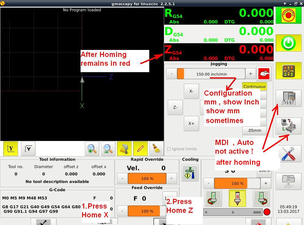

I want a new gmoccapy
After homing Z DRO remains in red !!??
I'm wrong or there is a bug ?

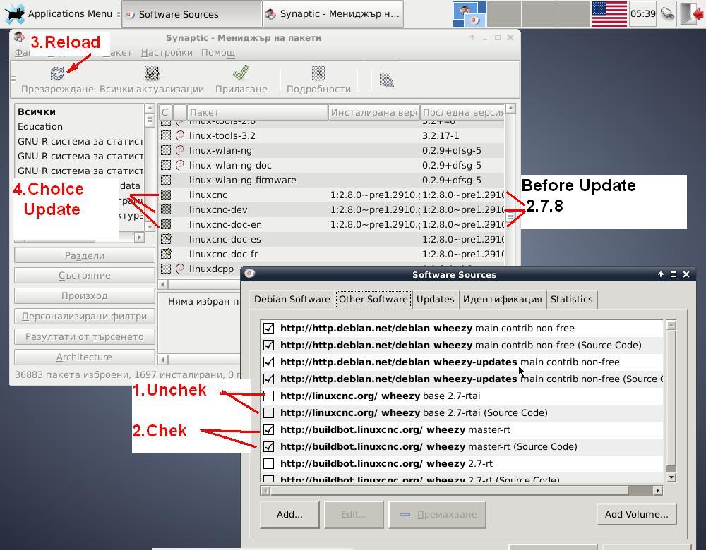

I like very much gmoccapy . We work on two lathe and a milling machine.
I want to use function "tool wear" in tool table . Therefore upgraded 2.7.8 => 2.8 .
Please see,done properly ?
Then I made configuration (applied)
P.S. After homing pin joint.0.homed = 1 , pin joint.1.homed = 0 !!??

A lathe is a identity kinematics, so you need 3 joints, X being joint 0 and Z being joint 2.
Joint 1 is unused and does not need to be in your ini file.
Change joints to 3 and rename your joint 1 to joint 2.
After that the dro problem should be gone.
Norbert

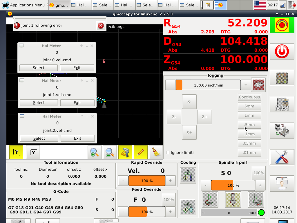

- dinkata
- Posts: 101
I did this,but there is another problem .This is config real machine :Change joints to 3 and rename your joint 1 to joint 2.
ini:
JOINTS = 3
KINEMATICS = trivkins coordinates=XZ

In this configuration, when pressed the button -X or +X normal move
but when pressed the button -Z or +Z joint.2.vel-cmd =0 joint.1.vel-cmd = 3
[ jog speed = 180mm/min ( and another problem show sometimes inch/min ) ]
joint.1 error !!!!!!??????
