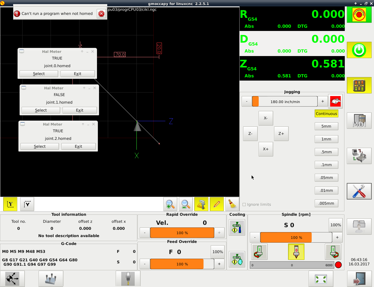

Please check, if there are any more joints in the config. Easiest is to look in hal show for all joints and the homing status.
Post again your last sim config.
Here it is working.
Norbert
Here it is working.
Norbert

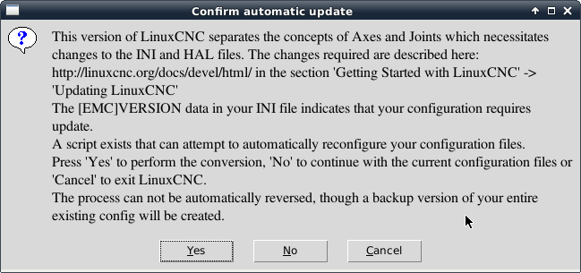

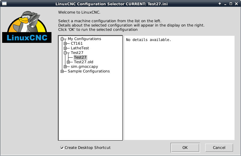

Hallo Norbert ,
I now test config I did in PC with Linuxcnc 2.7.8 ( attached after open in PC with Linuxcnc 2.8 pre )
Opening sequence :
1.Copy folder config "test27" in folder configs in PC with Linuxcnc 2.8 pre
2.Menu Linuxcnc
YES
3.Error

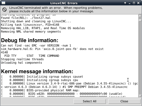

Corection in sim_hardware.hal and ini :4.Start , press Home Z , press Home X
MDI open , but command line not active !!??
Auto - open program , but not run !!!??
there is no JOINT_1 !!Please check

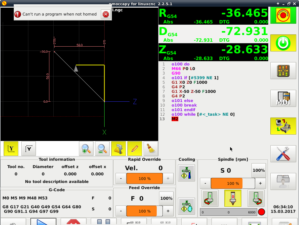

P.S. After Homing button MDI and button Auto not active
after pres jog X or jog Z then buttons active , but :
I want to help improve gmoccapy . I can do tests on the real machine !
Now new config Linuxcnc 2.8 with Joint 0 and Joint 1 work normal on Lathe ,
only DRO Z is red after homing !

This is somewhat odd. The conversion script really should change that pin name.
github.com/LinuxCNC/linuxcnc/blob/master...ipts/update_ini#L366
Did the conversion script appear to run correctly?

Hallo @all,
I am working on the solution, but it is more work than I thought, because I do not want to destroy the compatibility to older configs.
There is a work around for the mentioned problem.
Add for all unused joints lines like so:
I will inform, as soon as I got the solution finished.
But I will need another while.
Norbert
[JOINT_1]
HOME_SEQUENCE = 0I will inform, as soon as I got the solution finished.
Norbert
