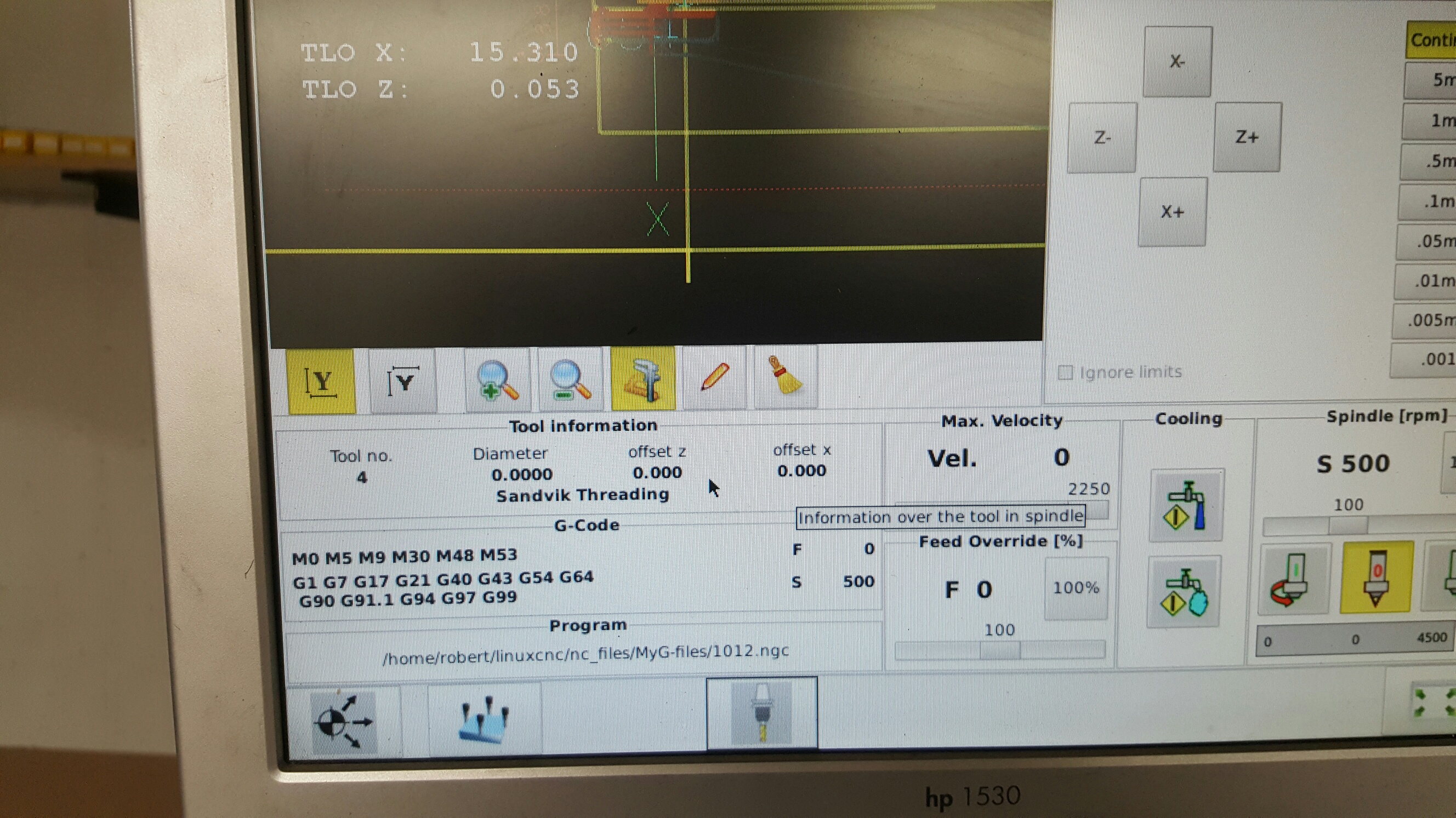

Tool offsets don't display on main screen.

Have you connected the tool-offset pins in your postgui.hal?
I bet you have not
See tool related hal pin
