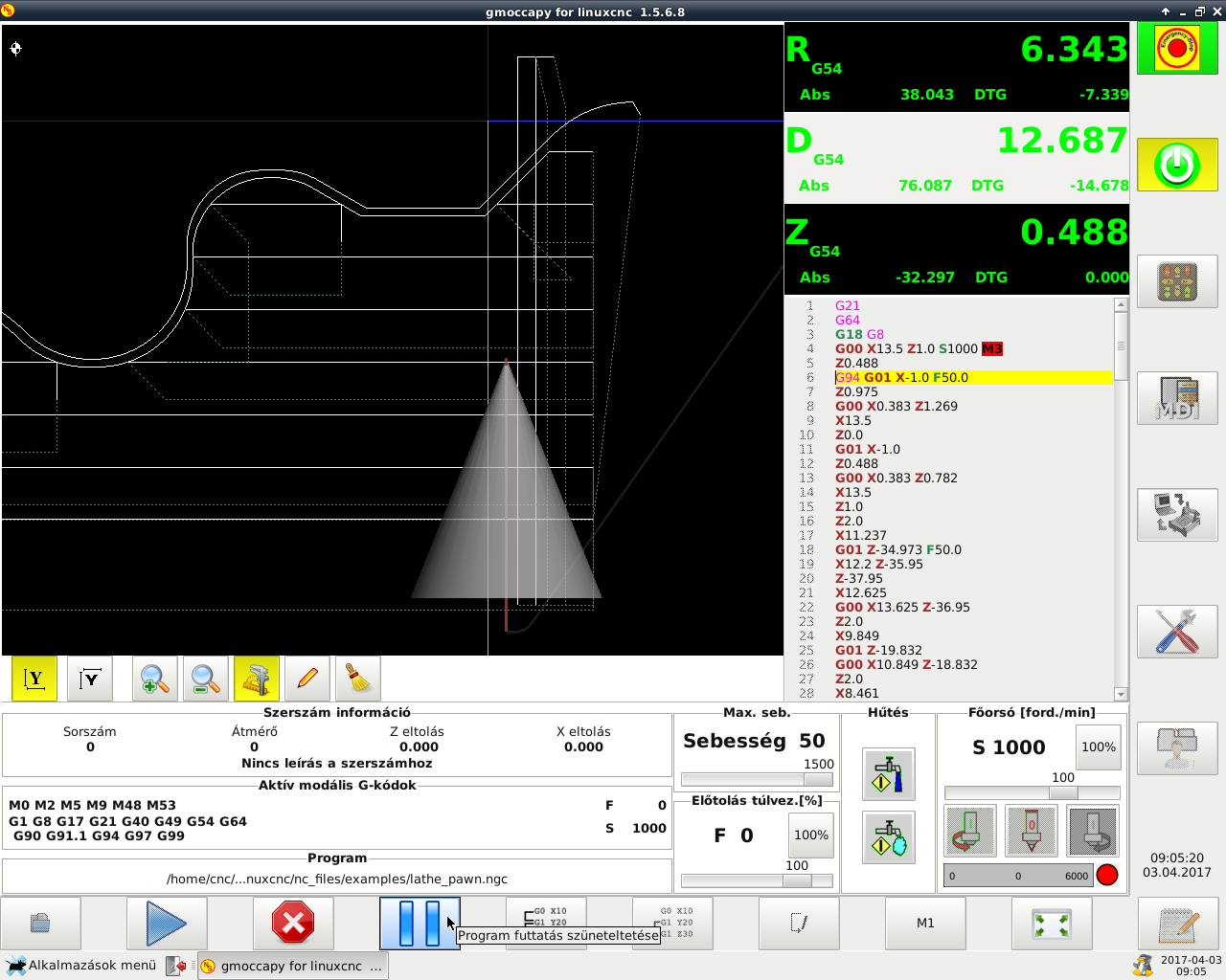

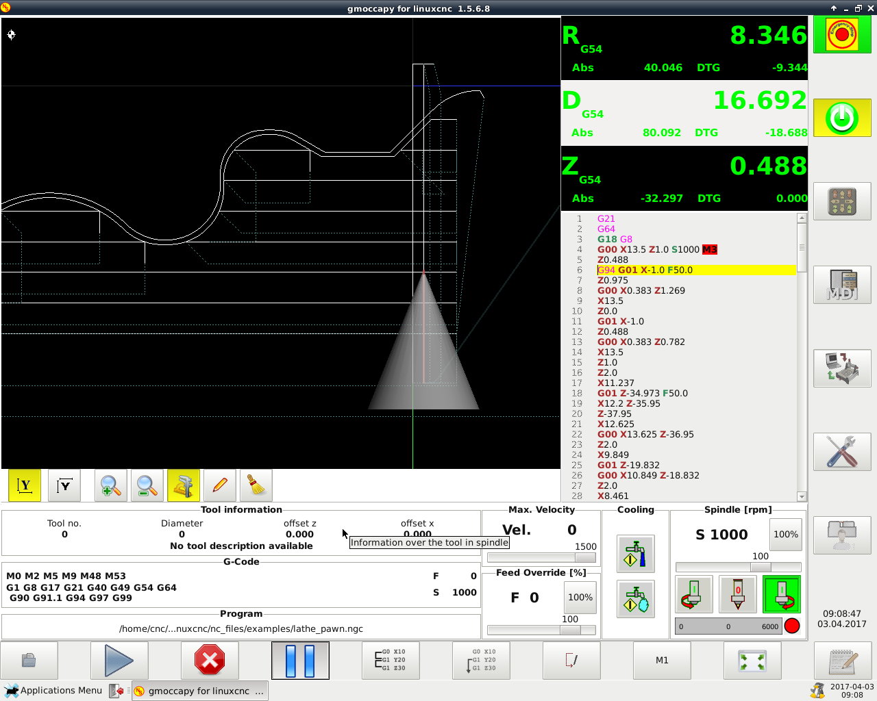

Hello,
probably I found a problem with gmoccapy gui. After changing linux language from English to Hungarian, the tool path line has additional offset. See the screenshots. When I set back the language to English the problem disappeared.
Both screenshots in on same line of program.
Know anybody solution for this?

21 Apr 2017 11:51 #91773
Replied by andypugh on topic Tool Path offset after changing language
I wonder if this is caused by some code (almost certainly Python) interpreting "," and "." differently when switching between languages?
I assume it isn't a tool-offset, as no tool seems to be loaded (cone rather than tool-shape)
