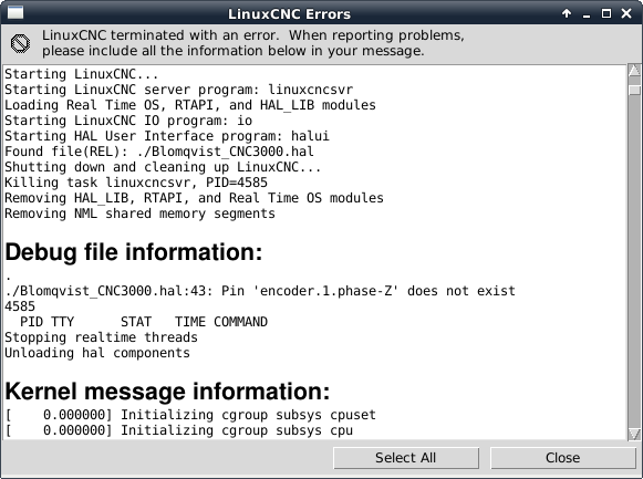

28 Apr 2017 10:21 #92253 by tecno
Replied by tecno on topic Spindel problems in Gmoccapy
Can somebody clarify the code from Norbert. I have only 1 par port = 0 and only index pulse on pin 10
What lines should be edited to suit above as I get nowhere with the code as-is.
Cheers
bengt

28 Apr 2017 14:43 - 28 Apr 2017 14:51 #92275 by newbynobi
Replied by newbynobi on topic Spindel problems in Gmoccapy
The changed code
# Spindeldrehzahl messen / mesurement spindle revolution #
loadrt encoder num_chan=1
addf encoder.update-counters   servo-thread
addf encoder.capture-position  servo-thread
setp encoder.0.position-scale 1      # Anzahl der Impulse je Umdrehung
setp encoder.0.counter-mode 1        # Wenn 1 gesetzt, wird B-Signal ignoriert
# disable 4 times encoder, otherwise each klick will ingreas jogwheel-count by 4 instead of 1
# 4-fach-Auswertung vom Encoder ausschalten, sonst wird jogwheel-count bei jedem Klick um 4 statt um 1 erhoeht
setp encoder.0.x4-mode FALSE
loadrt scale count=1                 # Wird gebraucht, um U/Sekunde in U/min umzurechnen
addf scale.0 servo-thread
setp scale.0.gain 60                 # Ausgang = 60 x Eingang
net spindle_index parport.0.pin-10-in => encoder.0.phase-A => encoder.0.phase-Z
net spindle-index-enable motion.spindle-index-enable <=> encoder.0.index-enable
net spindle-rps encoder.0.velocity => scale.0.in
net spindle-rpm scale.0.out
# Zum Erkennen ob Geschwindigkeit erreicht wurde
# For at Speed detection
loadrt near
addf near.0 servo-thread
# Stellt fest ob zwei Werte in etwa gleich sind
# Wahr wenn, in1/scale <= in2 <= in1*scale
# oder wenn |in1-in2| <= difference
# prooves if two values are roughly the same
# true  if  in1/scale <= in2 <= in1*scale
# OR |in1-in2| <= difference
setp near.0.scale 1.2
setp near.0.difference 10
net spindle-cmd => near.0.in1
net spindle-rpm => near.0.in2
net spindle-at-speed near.0.out => motion.spindle-at-speed
In your postgui.hal file you need:
net spindle-rpm         gmoccapy.spindle_feedback_bar
net spindle-at-speed    gmoccapy.spindle_at_speed_led
Norbert
Last edit: 28 Apr 2017 14:51 by newbynobi.

28 Apr 2017 14:56 - 28 Apr 2017 14:59 #92276 by tecno
Line 43
net spindle-index => encoder.1.phase-Z => encoder.1.phase-A
Last edit: 28 Apr 2017 14:59 by tecno.
28 Apr 2017 15:16 #92277 by newbynobi
Hallo bengt,
please use the changed code.
See my last post.
Norbert

28 Apr 2017 15:19 - 28 Apr 2017 15:22 #92278 by Todd Zuercher
Replied by Todd Zuercher on topic Spindel problems in Gmoccapy
I believe you only have one encoder so the pin names should be:
net spindle-index => encoder.0.phase-Z => encoder.0.phase-A
(There were also other places where encoder.1 should be changed to encoder.0, but Norbert corrected them while I was typing.)
