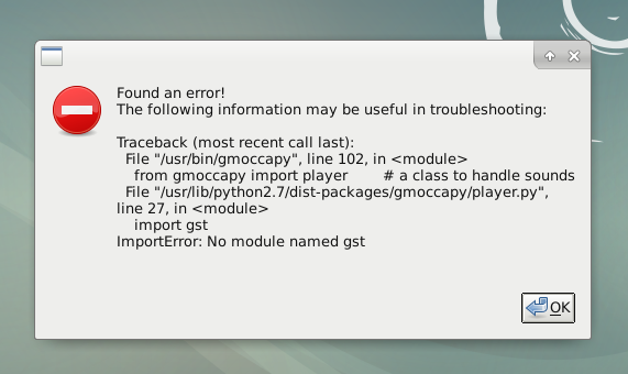

30 Jul 2017 15:19 #96683
by nonkeldw
Replied by nonkeldw on topic Error when launching LinuxCNC with Gmoccapy

30 Jul 2017 19:15 #96693
by newbynobi
Replied by newbynobi on topic Error when launching LinuxCNC with Gmoccapy
Are you running debian stretch?
If you run from normal 2.7 release CD, than you have not installed Python-gstreamer
If you run actal master brunch, just pull the latest release, I fixed that a few days ago.
Norbert
Norbert

31 Jul 2017 06:59 #96723
by nonkeldw
Yes, I use debian stretch.
Is that a problem for Gmoccapy?
Thanks.
Thanks.

31 Jul 2017 07:05 #96725
No, its just you have not installed one of the prerequisites.

- nonkeldw
- Posts: 39
31 Jul 2017 07:55 #96726
by nonkeldw
Hello
The packet "Python-gstreamer" is not available in the repository.
