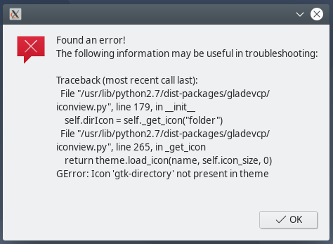

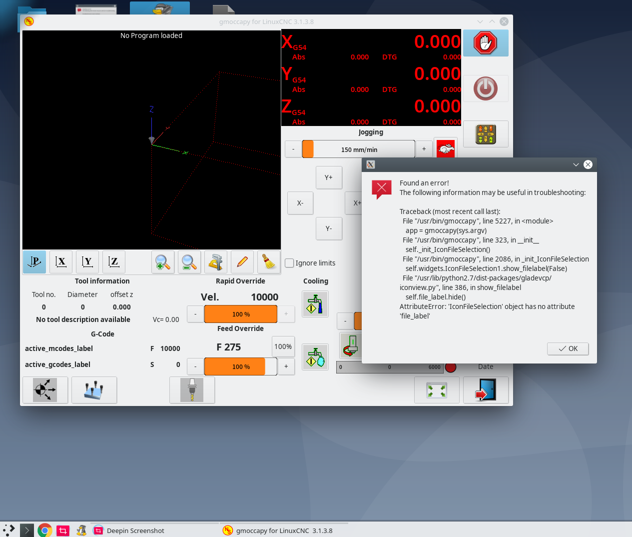

When I open Gmoccapy, an error window appears and the Gmoccapy screen appears, but it closes after a while.

I found the criminal!
Is this a compatibility issue?
I can finally sleep.
I switched my desktop to xfce and Gmoccapy started without any problems.Desktop environment : kdeconnectd

Yes that might be a problem with the icon theme. Gmoccapy currently uses the gtk icon names. So if no Gtk/Gnome compatible icon theme is installed the icon cannot be found and that error is displayed.
The master branch (2.9 prerelease) will use very soon the icon names of the freedesktop specification, that will avoid this problem (PeterMue is working on that).

Thanks to you, I was able to safely avoid the error by installing gnome-icon-theme.
