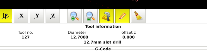

04 Aug 2017 10:11 #96997
by chrisfairbrother
Gmocappy- no z tool offset displayed was created by chrisfairbrother
I have changed from axis to gmocappy, and I am very impressed. The only problem is the z tool offset is always displayed as zero. If I apply a z tool length in the tool table, my cnc machine works correctly using the tool length, but the display is always zero (see pics). Linuxcnc 2.7.11 Gmocappy 1.5.8
many thanks
many thanks

Have you connected the corresponding hal pn in your postgui.hal file?
Have you issued a G43 after the tool change?
Norbert

Hi Norbert, Yes I have issued a G43 after the tool change. It must be the hal pin I am missing. I will check later today.
It's strange that the tool length is working, but not being displayed.

All working now. I was missing
"net tooloffset-z gmoccapy.tooloffset-z <= motion.tooloffset.z"
it was obvious once i looked at my hal file. I had removed some lines when I changed from axis to gmoccapy.
