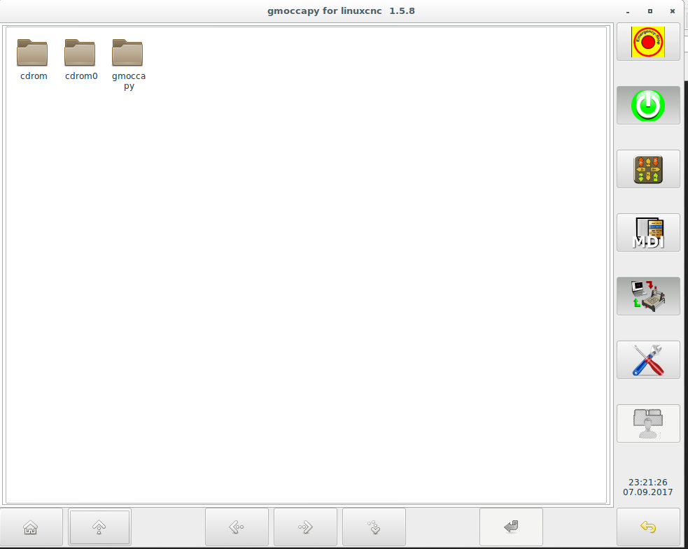

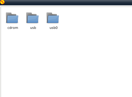

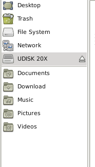

I am back after rebuilding part of the machine. All done and I was trying to see if I can access the USB drive as you suggested.
I can see the CD Rom , USB and USB0 but they are all empty, no files to be found there.
When I use the file manager, I can see and access the USB stick OK, copy from it etc. but I simply cant get there from within Gmoccapy.
Any ideas? Attached pictures show what I see.
Thanks,
JB
Thanks,
JB

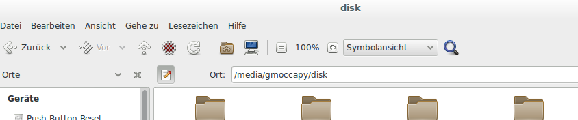

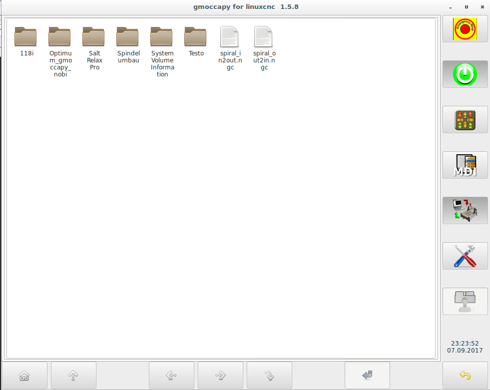

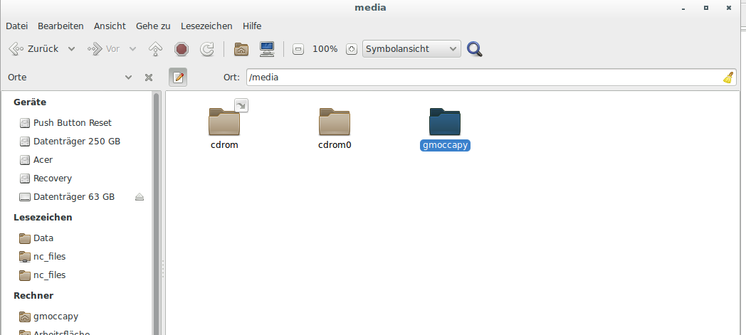

Replied by newbynobi on topic Navigate to USB when loading G-code file
I can access any USB Stick, just look where it is mounted and navigate to that location, The attached screenshots can give you a hand.
Norbert
