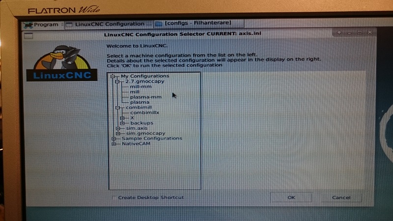

This how it looks like in my milling machine.
Obviously I have made something wrong, I can run combimillx from Combimill folder.
I can start mill-mm from from 2.7.gmoccapy but not run the mill.
What do I need to do/edit to get all this working? I want to have NCAM in USER TABS = how is this done?
Cheers
Bengt

26 Sep 2017 08:54 #99446 by newbynobi
Replied by newbynobi on topic gmoccapy + nativecam
Hallo Bengt,
please find attached the modified folder. Just copy it to your linuxcnc / configs folder and extract it. After that, go to a terminal and enter linuxcnc followed by ENTER.
Select the new config and watch the terminal for output.
In case the config does not start, just copy the content of the terminal and post it here.
I am not sure, if the copy from my ncam dir does work on your PC too. If you got problems, please delete the ncam folder from the new config folder and do:
To use with your own inifile, it must first be edited. From a normal user terminal, change directory to the one that contains your inifile Using the command : ncam -i(inifilename) -c('mill' | 'plasma' | 'lathe') will automatically create a backup and modify your file. It will also prepare the sub-directory with needed files and links. If you use axis and -t option it will be embedded in a tab
P.S. I am not at home, so i was not able to test with my 7e76e / 7i73 combination.
Norbert

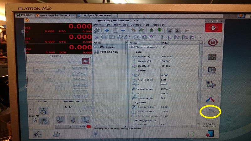

26 Sep 2017 10:41 #99452 by tecno
Replied by tecno on topic gmoccapy + nativecam
So far OK that NCAM is in user tab but it is empty
Deleted NCAM dir and try to ncam -i combimillx -c mill but it errors out = see bottom in enclosed text file.
File Attachment:
File Name: norbert.txt
File Size:9 KB
