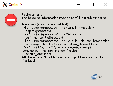

Hi Norbert. I would like to take you up on your offer. I am running Linuxcnc 2.7.11 on Debian Stretch. When starting linuxcnc with gmoccapy UI, an error box pops up. I can see the gmoccapy screen but when I close the error box, linuxcnc exits. BTW, this is over SSH with X11 forwarding enabled. Here is the terminal dialog.

And I attached the error box. I also commented out the lines as per the previous poster.
I hope you can point me in the right direction to start looking for a solution. Thank you.

Imho
Is the relevant error, the python exception is a follow upnerror, I hope!
What are you trying to do with the Logo file?
If you want to replace my logo, you have to do that replacing the original logo in /usr/share/gmoccapy/images
All out of memory, as i am not on my PC.
Norbert
P.s. for detailed help, please post your config folder
'/home/jim/linuxcnc/configs/SilverDragon/icon/Logo.png': No such file or directoryIs the relevant error, the python exception is a follow upnerror, I hope!
Norbert

Hi Norbert, thanks for your reply. I am not trying to do anything with the logo. I checked /usr/share/gmoccapy/images and it is there. It has warmed up a bit here so I went to the garage and ran linuxcnc locally and it loaded and ran so much of my problem must be related to running remotely over SSH. Anyway, I have linuxcnc 2.7.11 but it has gmoccapy 1.5.8. The original install was from linuxcnc-stretch-uspace--386-r9.iso. To get the latest gmoccapy, do I need to compile the whole installation from source or is there some way to update it? Thanks again.
