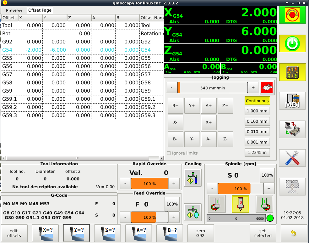

version 2.3.3.2 master branch
After power on, home all, then select touchoff menu, then edit offsets. After changing the value of one of the offsets and hitting Enter, the following error prints to the console:

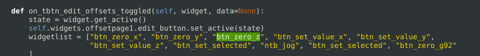

MANUAL Mode
In the glade file, there are indeed no buttons called btn_zero_x, btn_zero_y or btn_zero_z.

@Persie,
Strange, In glade the button is not available, the closest button over there is zero_g92
But in the python file you see one line of this button :
I did a short test as you described, by me it works fine :
Maybe you have done something wrong in your past screen development.
Advise : install a second clean backup version to test if there are problems.

Replied by persei8 on topic Missing buttons in gmoccapy
Well whatever happened, I fixed it. Now I have 3 buttons to quickly zero the X, Y and Z without the calculator popping up. I also rearranged the buttons nearly back to how they were in the original and restored the homing button bar. I think a little bit of python is finally sinking in.

Replied by newbynobi on topic Missing buttons in gmoccapy
That was a bug, I missed deleting the button in that list when I deleted them from the glade file.
I fixed that and I am about to push the fix in a moment.
