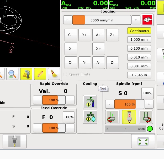

How can the scrollbars be made larger, like double the size? And the input line for MDI commands also larger.
I find it to be a bit of a precision touch to be in those areas on the 1920x1080 screen. Could be my finger tips, but well...

that widget is using default glade widgets, that result in "mouse usage"
I do agree, that it is anoing. To cange that, you have two options:
1. code a better mdi command widget
2. try to find a theme using bigger scroll bars.
Sorry, for the answer, thT unfortunately does not solve your problem

I saw you have Gmoccapy 2 in development state. There you have different style jog, speed etc sliders including + and - buttons on the end of slider. Can you say when it's coming out as stable release? I think it could solve that "hard to hit with touch screen" usage.

The Theme here has larger scrollbars:

I'll see if I can test the attachment above. This means there are "themes" in gmoccapy? So changing scrollbar size in a a theme only affects gmoccapy?
I did change the window system scrollbar size so all scrollbars everywhere are larger. That seems to work.
The MDI, and possibly also the G-code editor, could benefit from a larger font size. Where should I start looking? The MDI widget, where can I find that?

Yes Gmoccapy can select themes- go to it's setup page.
The theme should work if you put it in home/.themes folder (then it should show up in Gmoccapy's setup page.)

I tried a few things, in the end the absolutely best result was had by lowering the resolution of the display. There is a tool in the debian menu system to do that. I ended up with 1440x900 and gmoccapy fills out the screen nicely now.
Edit: I went down to 1368x768 resolution and gmoccapy in full screen mode. The input fields are now almost twice the size. I did have to create the 1368x768 mode since it wasn't already defined. Here is how
A video describing this and how to make the new resolution permanent is here
debian% cvt 1366 768 60
debian% xrandr --newmode "1368x768_60.00" 85.25 1368 1440 1576 1784 768 771 781 798 -hsync +vsync
debian% xrandr --addmode HDMI1 "1368x768_60.00"
debian% xrandr --output HDMI1 --mode 1368x768_60.00
