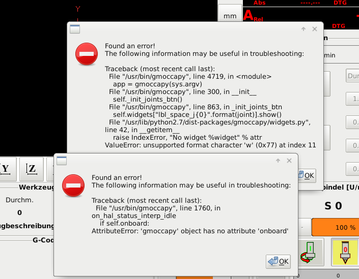

Hi
Sorry, me again
If I activate REMAP=M6 modalgroup=6 prolog=change_prolog ngc=change epilog=change_epilog
in
[RS274NGC]
PARAMETER_FILE = MeBigCNC3.var
SUBROUTINE_PATH = macros
RS274NGC_STARTUP_CODE = G17 G21 G40 G43H0 G54 G64P0.005 G80 G90 G94 G97 M5 M9
# turn on optional features in this case just INI and HAL reading
FEATURES=12
# This is the sub, with is called when a error during tool change happens
# The remap code
my screen seems to block, but after ca 2 min i get the error message.
If I comment that line everything seems to work normal.
I'm not sure if I need that for Norberts tool adjustment function ?

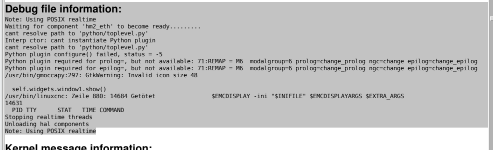

S O L V E D
Typical NRFM ( Never Read the Fucking Manual )
After several time looking in the Doc i found that I MUST COPY the directory PYTHON into my directory structur.
Now I have no more errors and see the touch off working.
Mike

11 Mar 2018 20:38 #107231
Replied by rodw on topic Remap T6 in gmoccapy error ?
It looks like it can't find toplevel.py from the screen dump. The folder might be python27 or something similar. I can't really help but that is the clue I would chase down.
