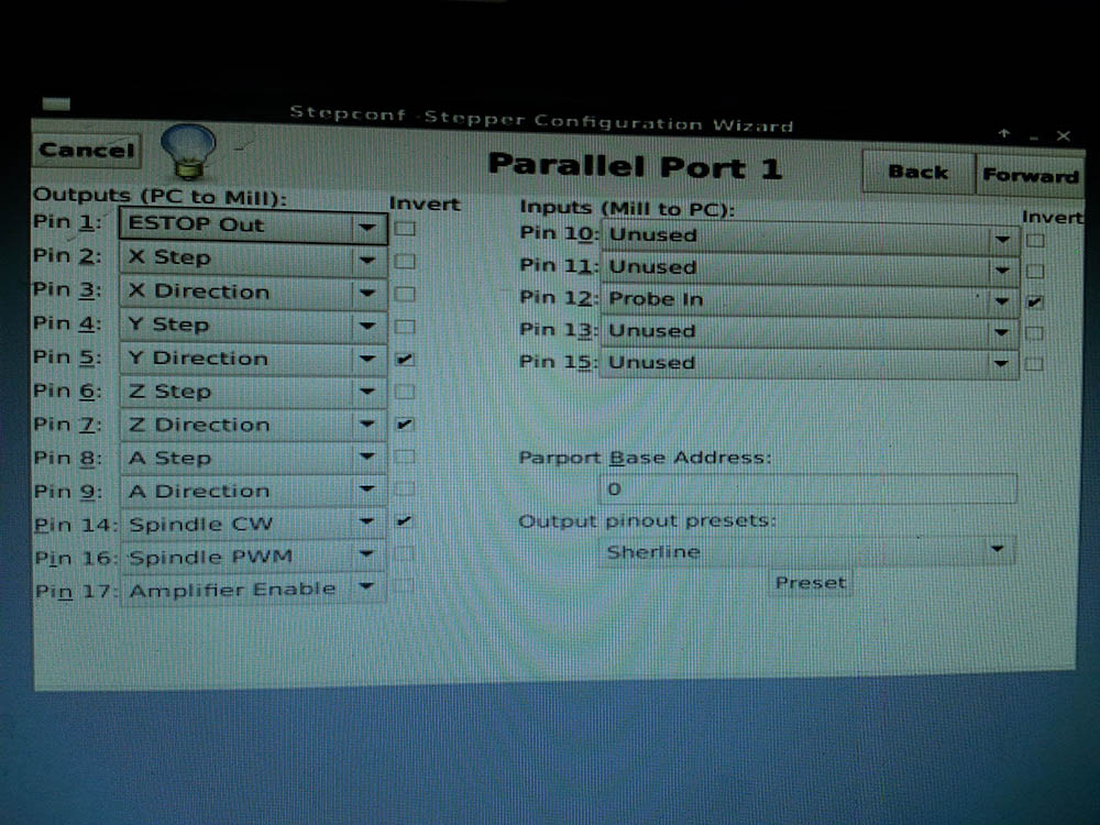

I see your machine is not working at the moment. Your port adress is not valid.
Did you have the machine working with any config? please sent the working config so i can see what you are doing.
Pictures are welcome. If the config work's but some things are not working. Please write down what is not working so i
can collect data.

Grotius,
my plasma table has been working for the past month or so using the Axis configuration I posted above. Do you need me to post the entire configuration folder?
What has not been working is only the Proma 150 THC unit which I attempted to implement to my table. I tried the Tommylight configuration which I was never able to get functional due to some Z axis errors I was unable to resolve. If you look at the last post on that thread you can see my table functioning without the THC.

I have not used a proma but from what I am seeing, you've copied a setup for a mill and you are still using some pins for a spindle which a plasma does not have so there is nothing connected to the proma.
At this point, you can't use stepconfig anymore. You must edit your hal file in a text editor as it does not know a plasma machine.
What I would expect to see is you be using the THCUD component in your Hal file
linuxcnc.org/docs/html/man/man9/thcud.9.html
This component has inputs for the Proma up and down signals.
John Thornton has a sample config for download here
gnipsel.com/shop/plasma/plasma.xhtml
Download the THC Up/Down comp.

If you have a chance to look over on page 13 of Tommylight's THC threa
Tommylight's THC threadd
you'll see that I already edited his .hal & .ini files, complete with the Arc OK, torch UP, torch DOWN and Probe Switch pins to fit my setup but for whatever reason I can't get that to work due to joint 2 (Z) errors. I took all the numbers from my functioning .ini file and plugged them into that config without any luck. Why they would work perfectly fine in one configuration and then not even be able to move the axes in another configuration is beyond my ability to comprehend.
In fact the machine would only turn on without an immediate error if I checked the "ignore limits" box: I was able to get the X & Y axes moving but only once before it would throw the limit error as it tried to allow me to get back within the table limits first and then the machine would turn off as I could never get the axes moved far enough to be out of whatever the limit error was being caused by. At least it would appear to be a limit issue from what I understand and I spent much time editing different parts of the .ini file back and forth, especially the limits figures, without any success.
Tommylight looked over my files I posted to his thread and could only find one minor error which on further investigation on my part was actually correct. I posted more info in response to his suggestion but have yet to hear any further feedback although it's been close to 10 days now.
In my feeble mind I can't help but wonder why there is not the ability to hook up a THC with something similar to the stepconfig program. Getting a functional THC with Mach3 was certainly not this difficult. Mach3 took me maybe a half hour to get THC going, this has taken me more hours than I care to recount. It's frustrating trying to reinvent the wheel. Does it have to be that way? I'm not sure at this point, but I doubt it. Seems like every page with info concerning LCNC plasma is "under construction" and has just enough info for someone with a computer programming background to make sense of. Looking at a sample config for me the uninitiated is like looking at chicken scratches in the dirt and trying to make sense of them! Maybe I just have too many irons in the fire and am overthinking things to the point that none of it is gelling for me.
Also I wanted to point out that my plasma table is running fine using the mill setup because the plasma torch is turned on and off using the mill spindle control, F9. My thought is that the spindle on/off label is just a matter of form and not substance? The plasma cutter is still getting a signal despite how the F9 is labeled, it can't tell the difference.
