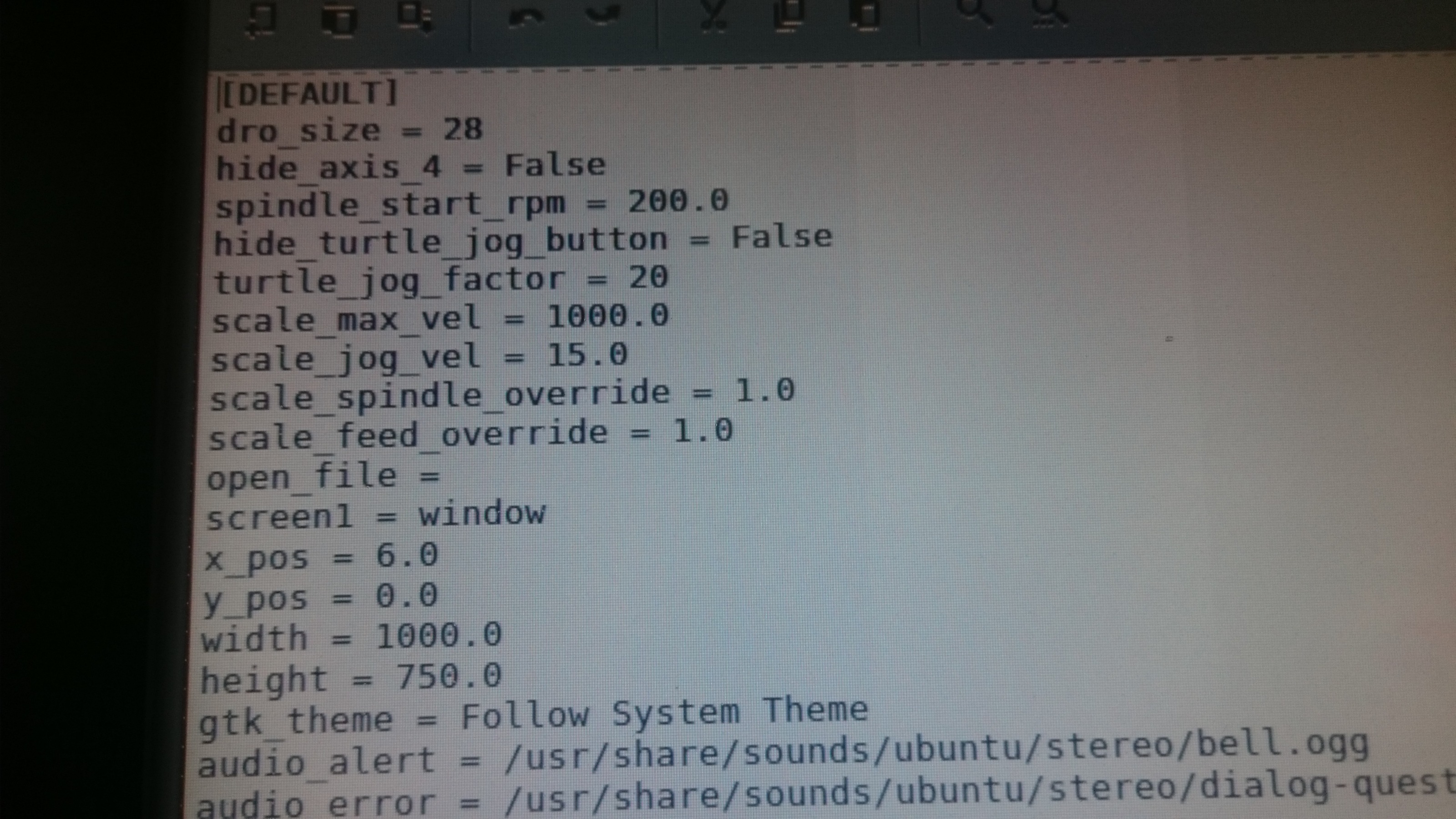

I have today setup gmoccapy on my lathe and I get following error messages.
Grateful if somebody can have a look and see what is wrong here.
Also there must be something wrong in latest 2.7.14 as the preferences comes out like this
scale_max_vel = 1000 <<<<<<<< must be very wrong 1 works OK

Something went wrong, we have an unknown spindle widgetGrateful if somebody can have a look and see what is wrong here.

Replied by tecno on topic New setup in lathe = error messages.
Update with hal ini and preferences and full terminal output.
