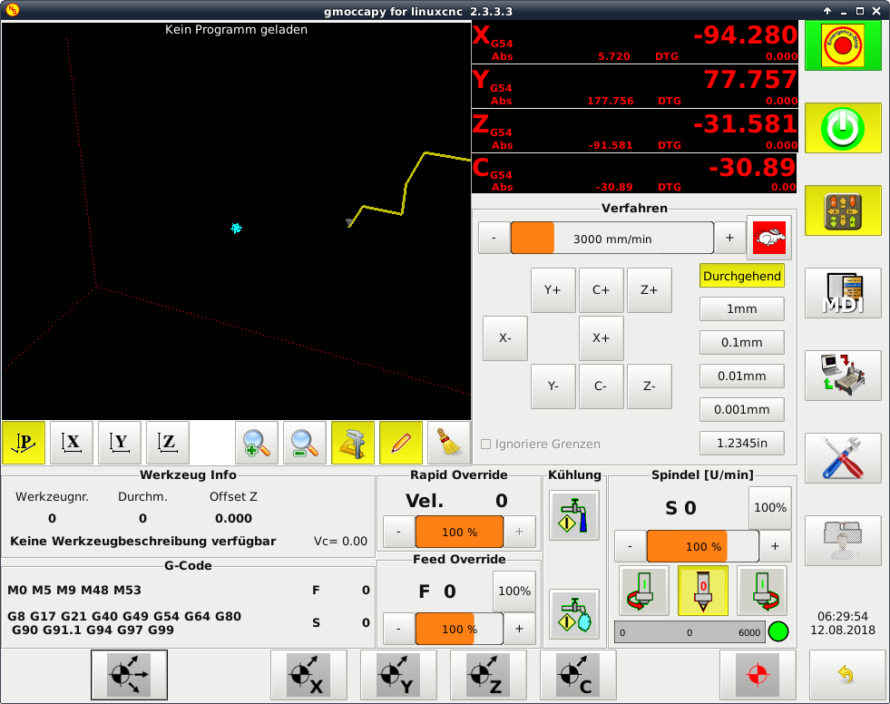

11 Aug 2018 09:21 #115879
by Weiler810T
Jog Axis no Function by last update was created by Weiler810T
Helo
When I press the X or Y or Z-button in manualmode, says linuxcnc
wrong motion mode ?
The error came only with the last update, before the machine ran perfectly
Last update
Linuxcnc
My old Config. Axis2.5.4 and Gmoccapy 2.7.12 works fine, no Probs
Any idea ?
wrong motion mode ?
**** GMOCCAPY INFO : postgui halfile = gmoccapy_postgui.hal ****:
Emit interp-run
1 2
MANUAL Mode
Emit interp-run
wrong motion mode, change to the correct one

11 Aug 2018 12:10 #115881
by newbynobi
Replied by newbynobi on topic Jog Axis no Function by last update
Gmoccapy in master do support the new feature joint axis mode, so you need to adapt your config.
What happen after homing the machine?
Norbert
Norbert
- Weiler810T
- Visitor
11 Aug 2018 15:41 #115891
by Weiler810T
Replied by Weiler810T on topic Jog Axis no Function by last update
Hallo Norbert
The new feature joint axis mode was already adapted beforehand.
After honimg Maschine is the same Proplem in manualmode, the jogwheel works though.
I can move all axes with the jogwheel in maualmode, but the jog-button no funktion.

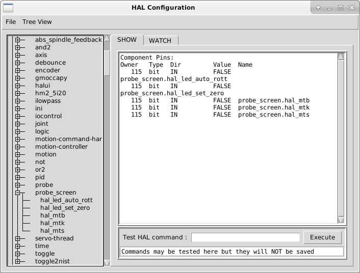

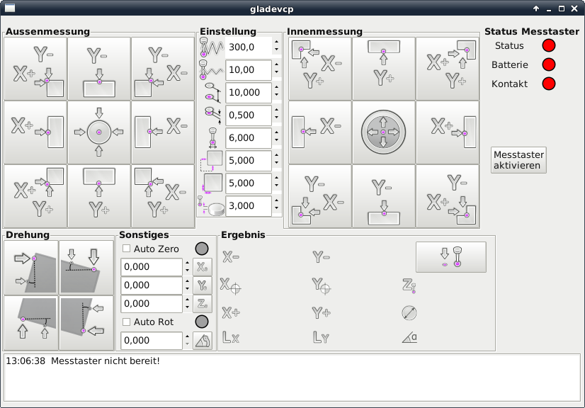

- Weiler810T
- Visitor
15 Aug 2018 11:23 - 15 Aug 2018 14:15 #116078
by Weiler810T
Hallo Norbert
The pin is for messtaster,but at the last 1000 updates works
gladevcp.hal_mtk > Kontakt
gladevcp.hal_mtk > Status
gladevcp.hal_mtb > Batterie
Siggi
# Name of display program, e.g., tkemc
DISPLAY = gmoccapy
EMBED_TAB_NAME = Weiler_810T
EMBED_TAB_LOCATION = box_right
EMBED_TAB_COMMAND = gladevcp -x {XID} -H Weiler_810T_panel.hal Weiler_810T.glade
DEFAULT_SPINDLE_SPEED = 150
# PREFERENCE_FILE_PATH = /home/chiron/linuxcnc/configs/ChironFZ16/gmoccapy.pref
EMBED_TAB_NAME=Probe Screen
EMBED_TAB_LOCATION = ntb_user_tabs
EMBED_TAB_COMMAND=halcmd loadusr -Wn gladevcp gladevcp -c gladevcp -u python/probe_screen.py -x {XID} probe_icons/probe_screen.glade gmoccapy_postgui.hal
#### Renishaw Messtaster ########
#net probe-in1 debounce.0.5.in <= hm2_5i20.1.gpio.051.in
#net probe-in debounce.0.5.out => motion.probe-input => gladevcp.hal_mtk
net probe-in hm2_5i20.1.gpio.051.in => motion.probe-input => gladevcp.hal_mtk
net probe-err hm2_5i20.1.gpio.052.in_not => gladevcp.hal_mtk
net probe-bat hm2_5i20.1.gpio.053.in => gladevcp.hal_mtb
# net renishaw hm2_5i20.1.gpio.055.ingladevcp.hal_mtk > Kontakt
Siggi
Last edit: 15 Aug 2018 14:15 by Weiler810T.
- newbynobi
- Posts: 1931
- Thank you received: 394
15 Aug 2018 16:03 #116084
by newbynobi
Hallo,
than that one is a race conflict.
Do not connect Hal Pins of Glade embedded Panel in the postgui.hal file, as some Glade Panel are loaded completely after the GUI, thats why you should add an Hal file to the embedded tab.
Norbert
Norbert
- Weiler810T
- Visitor
18 Aug 2018 09:47 #116236
by Weiler810T
Servus Norbert
Irgendwas beißt sich da in den Hintern
Starten mit probe_screen.pins in der gmoccappy.hal
Starten mit einer probe_screen.hal
Wenn ich ohne probe_screen.hal starte, startet Gmoccappy und die die probe_screen pins sind vorhanden.
Any idea ?

Note: Using POSIX realtimeStarten mit einer probe_screen.hal
Debug file information:
./probe_screen.hal:8: Pin 'probe_screen.hal_mtk' does not exist
2893
PID TTY STAT TIME COMMAND
Stopping realtime threads
Unloading hal components
RTAPI_PCI: Unmapped 65536 bytes at 0x7fb2f4ef0000
RTAPI_PCI: Unmapped 65536 bytes at 0x7fb2f4ee0000
Note: Using POSIX realtimeWenn ich ohne probe_screen.hal starte, startet Gmoccappy und die die probe_screen pins sind vorhanden.
Any idea ?
