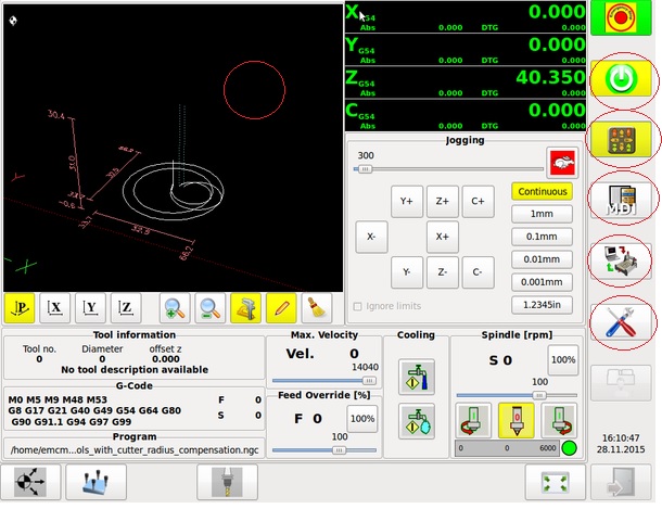

Hi, im new on Linux and Gmoccapy, i have question is possible to change icons and color on background on icons, and background (this black one) on interface -> can i put some logo there?
Where i can find code and localization to do it this change?
Thanks!
Thanks!

Hello! I think it's possible to do it, by using glade editor and changing gmocapy.glade file in /usr/share/gmoccapy.
For the translation, you can follow these instructions, they are all the same for all linuxcnc components
wiki.linuxcnc.org/cgi-bin/wiki.pl?Internationalization

To change collors go to the settings page and select any installed theme.
The icons are locatet at /usr/share/gmoccapy/images so changing that ones is no problem.
Do not rename or delete icons! Just replace them!
Icons best size is 48x48 pixel.
Norbert
Norbert

by newbynobi
Replied by newbynobi on topic Gmoccapy edit interface
The glade editor will work fine, if you get the source of glade 3.8.6 and than compile that one from source. I have mine working on Debian 9, Mitn 19.3 and Mint 20 . I start the glade editor from a rip-environment using a basjh script.
It is a little bit dangerous to edit the gmoccapy.glade file, if you do not know exactly what you are doing. Do not rename widgets, so not delete widgets and you will be fine. Moving them around should not destroy the glade file.
If you want to change widgets sensitive state at start up, or during the normal use, you will need to edit the gmoccapy.py file with a text editor or a IDE. Just look for call to sensitized widgets and change the parameter content of the list given.
And IMHO you are using 2.9 branch, that is an development branch, not recommended to be used on productive machines. Me and many others are working on that branch to change from python 2 to python 3 and also to GTK3. So any change of code in that manner could brake your config. Please use 2.8 branch, compile glade from source and uninstall all glade stuff from the package manager.
Norbert
Norbert
