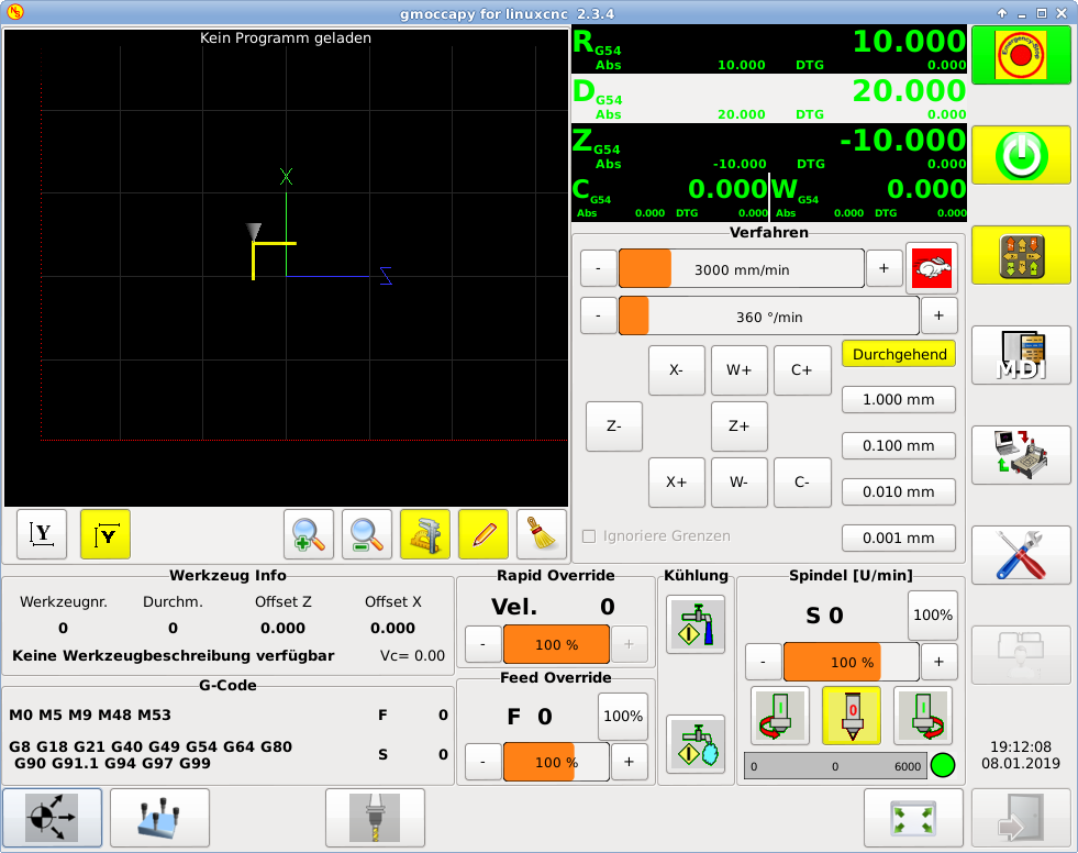

03 Feb 2019 16:59 #125586 by newbynobi
Replied by newbynobi on topic Turret Lathe with Turret Tailstock Setup
Hallo Vitran,
sorry for jumping in so late. I am just about to push gmoccapy 3.0 and the new one will support also lathes with additional axis like the one you describe. The layout may not be exactly what you want, but IMHO it is quite near.
If you are willing to test, just get a copy from
gmoccapy github
That branch do include several lathe configs.
Norbert

03 Feb 2019 21:43 #125612 by Vitran
Replied by Vitran on topic Turret Lathe with Turret Tailstock Setup
Norbert,
Is there anything for having a tailstock tool and turret tool in the gmoccapy 3.0?
