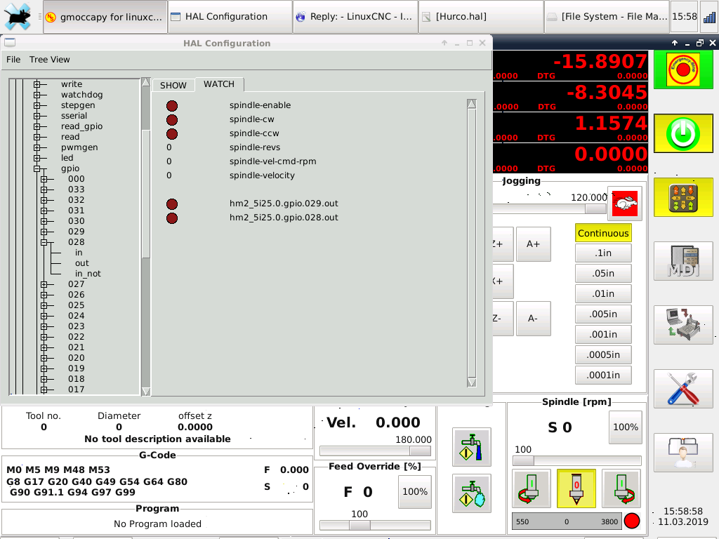

- biqut2
- Posts: 97
- Thank you received: 5

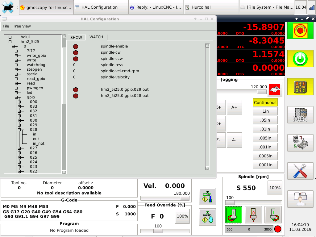

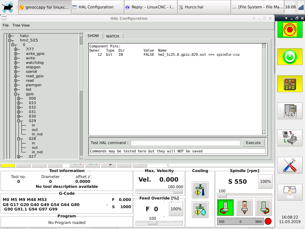

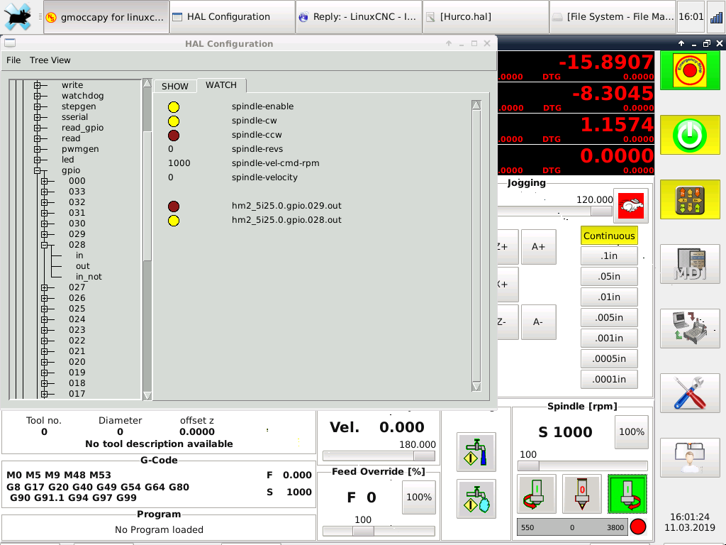

11 Mar 2019 22:15 #128386
by biqut2
# Generated by PNCconf at Sun Dec 31 20:00:49 2006
# overwritten when you run PNCconf again
I don't have those exact signal in my hal tree, however I do have the following:
First screen shot is after starting up linuxcnc
Second is with CW button depressed, the output changes state and the spindle and vfd respond accordingly
Third is with the CCW button depressed, nothing seems to work
Fourth shows the net in hal
I could take a screen shot but it wouldn't show anything, after trying the ccw button the cw button stops working and just flashes green and then turns itself off and wont work. Hopefully this will clear some things up, thank you in advance for the assistance. Also one last thought, the vfd doesn't control the spindle speed, The spindle has a gearbox on it and it is controlled independently of the vfd.
