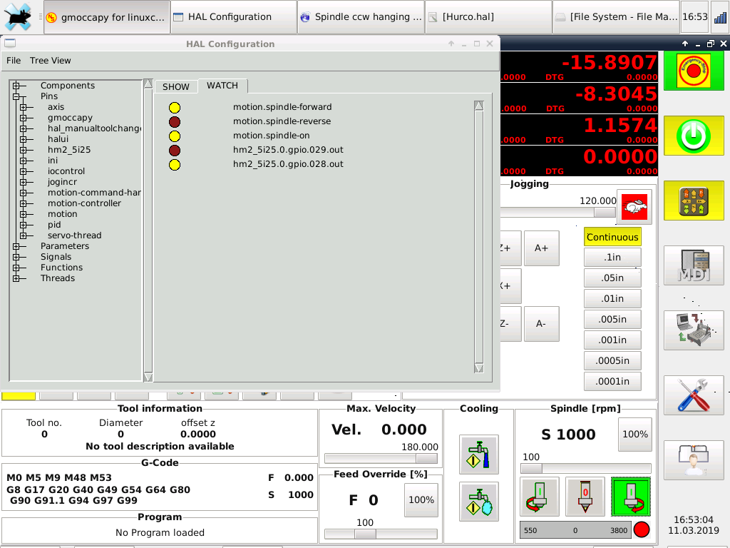

11 Mar 2019 22:48 #128394
Replied by andypugh on topic Spindle ccw hanging
That HAL looks OK to me.
But: You are looking at signals. It would be useful to look at pins. Specifically motion.spindle-reverse.

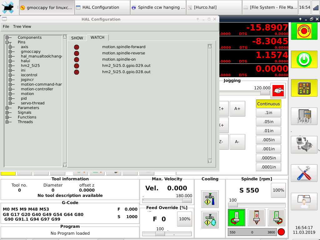

- biqut2
- Posts: 97
- Thank you received: 5
11 Mar 2019 22:56 #128395
by biqut2
CW
CCW
Replied by biqut2 on topic Spindle ccw hanging
CW
CCW
- Grotius
- Posts: 2419
- Thank you received: 2349
11 Mar 2019 23:03 #128396
by Grotius
Replied by Grotius on topic Spindle ccw hanging
Hi Andy,
He is doing set parameter i see now. I saw it as net command, i need glasses
The fastest way for him is to look in the list of gmocappy gui signals in HAL.
The Gpio list is problably a mesa list. If he looks for the gmocappy gui list in the same tabel. he can compare the
value's. Gmocappy has also a output pin for M4.
11 Mar 2019 23:03 #128397
One odd thing I notice is that it is showing S550 and the reverse button.
When I try it here, it shows S -550 for reverse.
Do you have a minimum speed configured somewhere? (I see that the bottom number on the slider is 550)
I am wondering if, because -550 is less than 550, the GUI is refusing to command that speed.

- Posts: 97
11 Mar 2019 23:13 #128400
by biqut2
I'm scanning through config files looking for a minimum speed setting, any idea where it might be?
