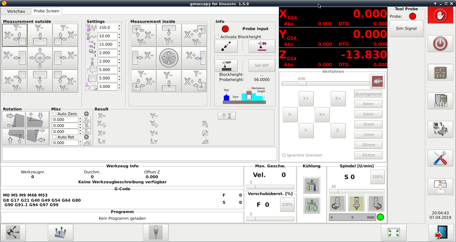

But now everything is working as it should. I adapted the change.ngc:
I used probe_screen.py as basis and added functions. First I probe the z-zero and after that the blockheight and safe the value to a hal pin. If the checkbox "Activate Blockheight " is not set, the gmoccapy blockheiht is used
I added all the Files, if someone is interested....
Thanks for the help
Matthias

Till now I am not an Expert in G-gode. I use AutodeskFusion which generates the code. To be honest, I was wondering about that as well, but it worked. Later I will take care of that....You ngc code is IMHO a mess
