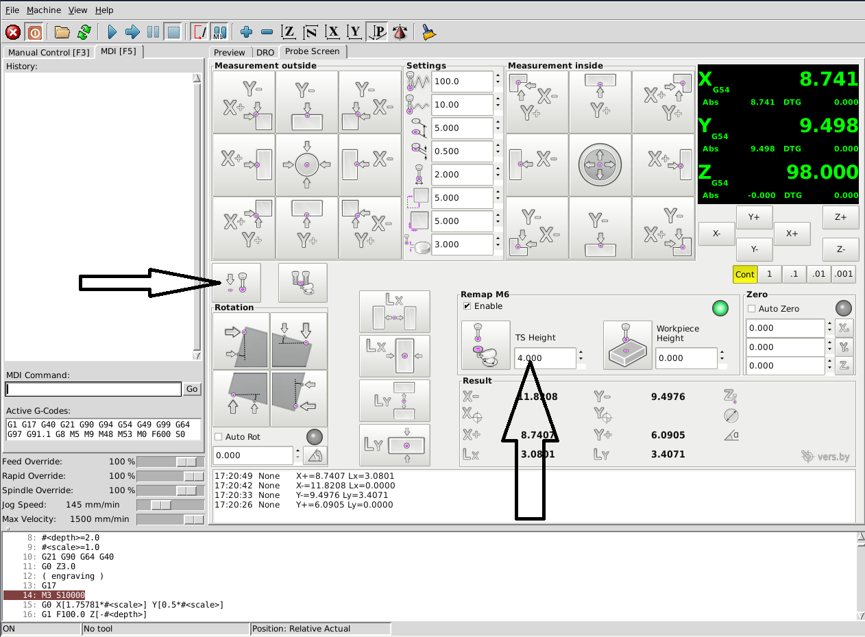

Home all axis
move to toolheight probe, X and Y are clear to me but Z confuses me so I would like to get help on how-to set all correct.
[TOOLSENSOR]
# Absolute coordinates of the toolsetter pad
X = 10 >>>>>> 419.5
Y = 10 >>>>>> 95
# Absolute Z start search coordinates
Z = 60 >>>>>>>>>>>>>>>>>>>>>>>>>>>>>>>>>>>>>>>>>>>>>>>>>>>>>>>>>>>> This is confusing
# Maximum search distance and direction (sign)
MAXPROBE = -60 >>>>>>>>>>>>>>>>>>>>>>>>>>>>>>>>>>>>>>>>>>>>>>>>>>> Want to start from Z home
# Speed of movements during working in Probe Screen
RAPID_SPEED = 600
# Diameter of toolsetter pad
TS_DIAMETER = 12.7
# The speed of the reverse rotation of the spindle when measuring the tool diameter
REV_ROTATION_SPEED = 300
Left arrow in picture I get a negative value of -112.0667 and it is here the confusion starts.
I want to get my MP10 probe to be my master tool T1
Tool table is empty
How do I get all correct to the set correct TS height?
Is it the dimension from table to probe top that is the TS Height? That is measured to be -93.5
05 May 2019 09:05 #132840 by pl7i92
Replied by pl7i92 on topic Probing setup
ts height is from the coordinate system
the G10 Z Value

the Hook is on REMAP make that off first
then switch to absolute in the DRO
you will see the same number in Z as it showes
I shoudt say that i run in lots of trouble by Probescreen so i made a pyvcp and 5 Buttons
and do touchoff by Button and mdi command
depending on coordinate system loaded and need to be loaded for probescreen it can crach the whole mashine
Therfor the tool sensor is on G30 position
Last edit: 05 May 2019 09:23 by pl7i92.
