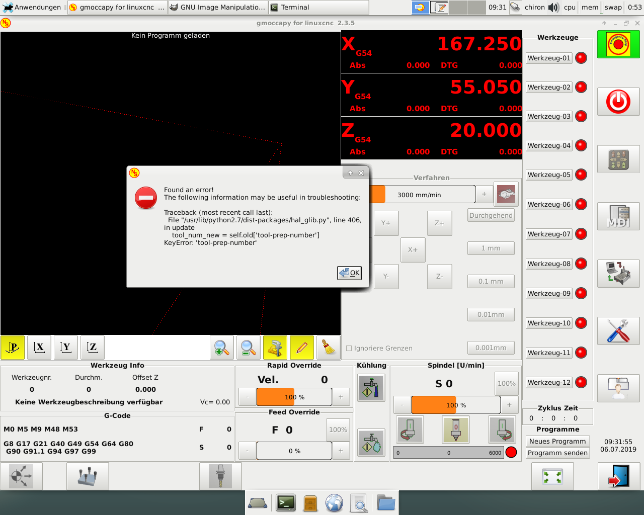

by Weiler810T
New Error was created by Weiler810T
- phillc54
- Posts: 5711
- Thank you received: 2100
06 Jul 2019 05:22 #138729
by phillc54
Replied by phillc54 on topic New Error
That was fixed earlier today, you will need to update again.

- Weiler810T
- Visitor
07 Jul 2019 02:13 #138776
by Weiler810T
Replied by Weiler810T on topic New Error
Proplem solved
Next Proplem is : 3 Achtung: Fehler X-Achse!joint 0 following error
emc/task/taskintf.cc 942: Error on joint 0, command number 233
What is that ?
What is that ?
- newbynobi
- Posts: 1931
- Thank you received: 394
07 Jul 2019 03:49 #138787
by newbynobi
Replied by newbynobi on topic New Error
following error = Schleppfehler
You joint / axis can not follow the commanded movement due to acceleration or speed isue.
Nothing to do with gmoccapy
Norbert
Norbert
- Weiler810T
- Visitor
07 Jul 2019 05:03 #138790
by Weiler810T
Servus Norbert
Yes, I know, but what asserts command number 233 ?
Siggi
Siggi
- Posts: 19908
- Thank you received: 4659
12 Jul 2019 07:06 #139165
Replied by andypugh on topic New Error
I think that is line 233 in the G-code file.
- Weiler810T
- Visitor
13 Jul 2019 01:30 #139232
by Weiler810T
I think that's a bug that can be replicated.This only happens after the reference run. If I start a program afterwards, the error message appears. If I move the axis by hand and then start the program, the machine runs for hours without error.
Siggi
Siggi
- Posts: 19908
15 Jul 2019 08:56 #139428
This sounds very strange Can you confirm what you mean by "reference run" and "move the axis by hand"
