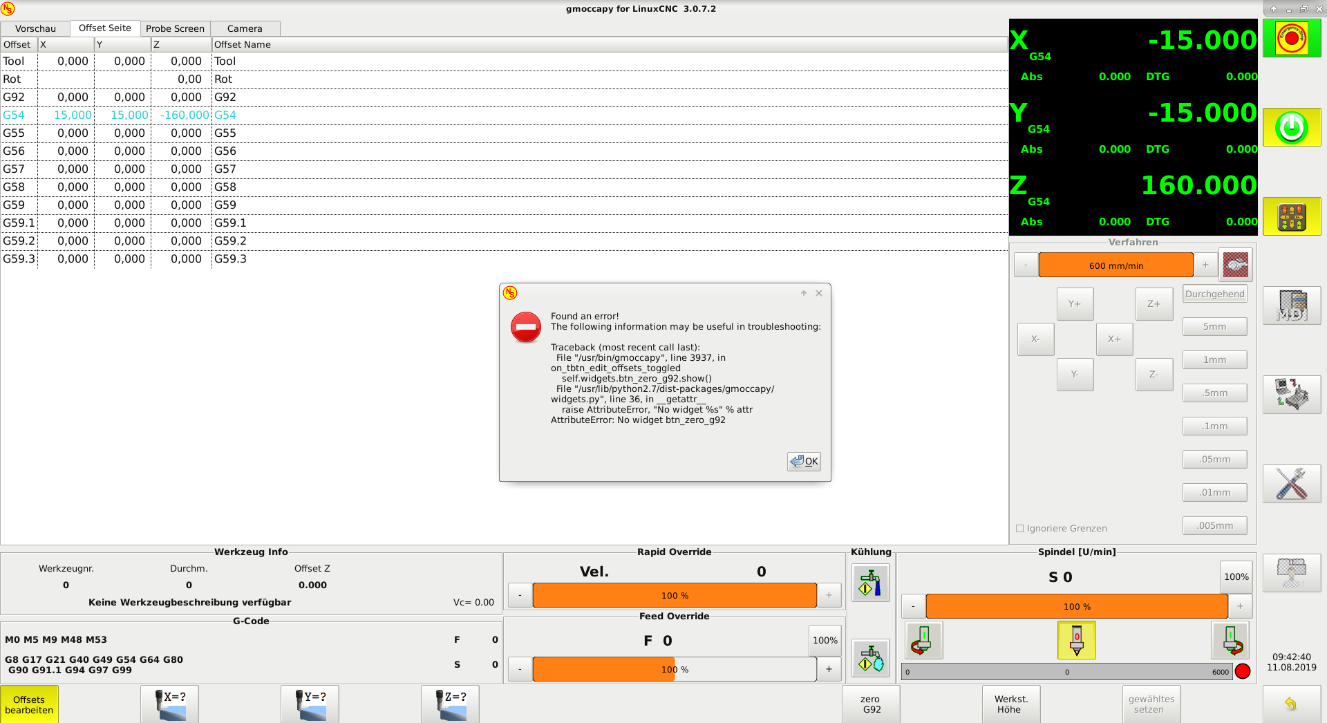

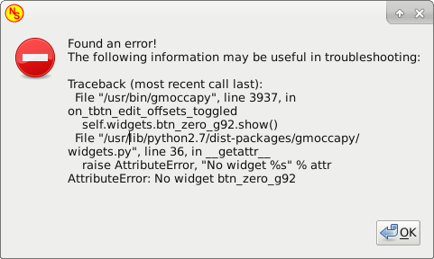

Gmoccapy 3.0.7.2 Error Offsets Button
- linux_tux
- Posts: 4
11 Aug 2019 11:06 - 11 Aug 2019 15:19 #141906
by linux_tux
Gmoccapy 3.0.7.2 Error Offsets Button was created by linux_tux
Last edit: 11 Aug 2019 15:19 by linux_tux.

12 Aug 2019 07:18 #141952
by newbynobi
Replied by newbynobi on topic Gmoccapy 3.0.7.2 Error Offsets Button
This is caused due to the dynamic widget creation?
I will fix it this evening!
Norbert
Norbert

12 Aug 2019 19:34 #141987
by newbynobi
Hallo Ralf,
it has been a little bit cumbersome, but it is fixed now. If you pull and get 3.0.7.3, than the error will be gone. I pushed to 2.8 and master.
Thanks for reporting!
Norbert
Norbert
