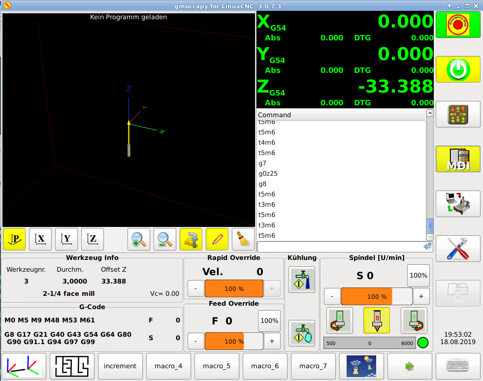

Hallo,
this new release gives you the possibility to add images to macro button.
The given images will be resized to fit the buttons (72x48).
The macro file need to contain a line like
the path must be absolute or relative to your config dir, "~" is allowed in path.
I recommend to make an image folder in your macro folder and place the images there.

- 0x2102
- Posts: 223
- Thank you received: 88
10 Sep 2019 16:45 - 10 Sep 2019 16:47 #144748
by 0x2102
Replied by 0x2102 on topic gmoccapy 3.0.8 is out!
Thanks Norbert for all your hard work on the new 3.x release. I really appreciate it.
I noticed a potential bug in 3.0.8 with my Lathe setup when in G7 (diameter mode). When I use the Jog Buttons e.g. 5mm / 1mm / 0.5mm etc. it will actually only move the Z-Axis 1/2 the distance. So pressing 5mm will move Z by 2.5mm. Pressing 1mm will move Z by 0.5mm etc.
The X-Axis is working fine.
Regards,
-Markus
PS: This is with LCNC 2.8
Regards,
-Markus

11 Sep 2019 03:05 #144793
by newbynobi
Replied by newbynobi on topic gmoccapy 3.0.8 is out!
Hallo Markus,
That is not a bug, it is a feature!
If you are in diameter mode and you have 26 mm diameter what you want to turn down to 25 mm, you can use the 1 mm jog increment and all is ok.
You will notice, that being in radius mode, the jog increment 1 mm will jog also the Z axis 1 mm.
So the behavior is different in G7 or G8.
I have been ask by several lathe power users to implement this.
Norbert
