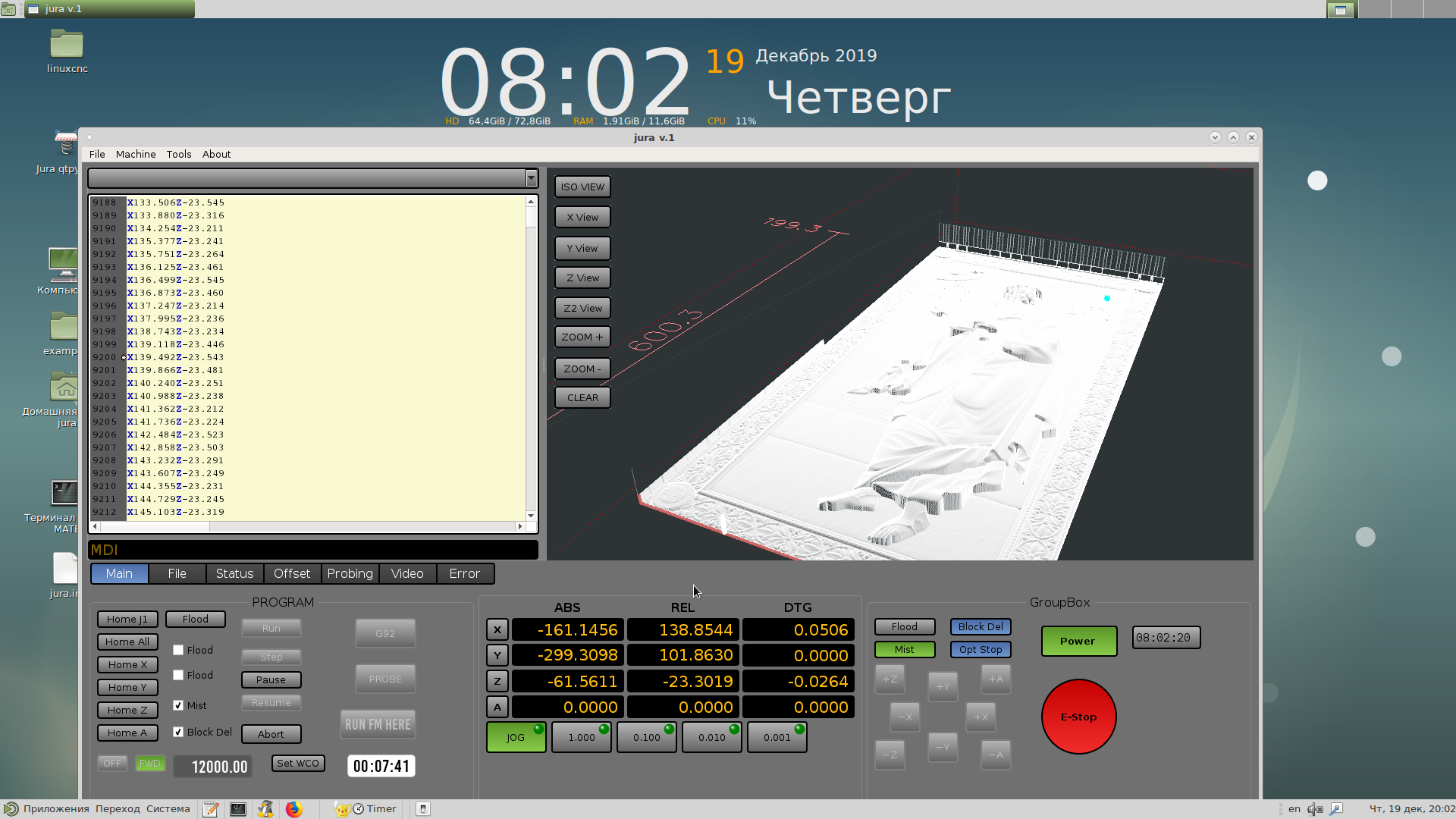

Hi! I have a desktop computer cpu core i3-560 ram 12Gb. Installed DebianStretch9 + linuxcnc 2.8pre-1.540.
Gmoccapy 3.08.2 super! But there is a problem downloading file 35Mb. Well, a very long time, the visualization is bad and you can’t touch it. In this plan, the Qtpyvcp brender works well. If so done in Gmoccapy, he would be the best!
Thanks for attention!

I have never loaded a f. 'le of that size is this just a matter of loading time? I Know that the preview is very slow but I have not. coded t hat part

How can I send you a file so that you can download and you will see what I mean. And compare with the download in the Qtpyvcp Brender simulator.

I just downloaded the file, should be able to test till weekend

Here is the file in work. Pay attention to the loading of RAM and CPU.
