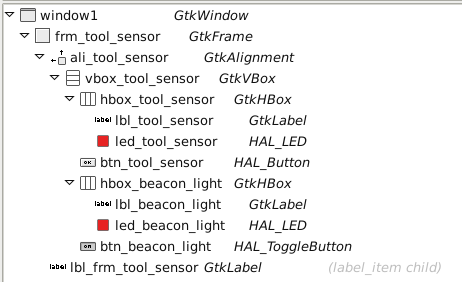

Hi.
In the events of trying to understand hal pins outputs and so on, I am currently trying to add a button that can light a led signal.
My starting point was to copy the tool_sensor files and trying to duplicate the whole thing, just with a button that should light a led
Im pretty shure that it is some naming that I have wrong ( I can't quite destinguis between a name tool_sensor and a function or element tool_name) It might also just be the chain of events that I dont understand:
Here is what i currently have:
1:The tool_sensor is embedded in gmoccapy and the botton toogles the probe led (so loong so good... (bad danish translation
2: I oppened glade and made a new led and new button "beacon_light"
this shows up in gmoccapy
I then went to the tool_sensor.hal file and tried to mimic the input (here is where I might have failed in regards to a name and a "function".)
#tool.sensor.hal input lines
net tool_sensor tool_sensor.btn_tool_sensor
net tool_sensor motion.probe-input
net tool_sensor tool_sensor.led_tool_sensor
#this is the inputs Made. replaced the tool.sensor with beacon_light
net beacon_light tool_sensor.btn_beacon_light
net beacon_light estop-ext
net beacon_light tool_sensor.led_beacon_light
If i # the 3 lines out, gmoccapy shows the panel just fine, but if I un# them the panel wont show in gmoccapy.
Ini entry:
#USERTABS
EMBED_TAB_NAME = OSCO tooling
EMBED_TAB_LOCATION = box_right
EMBED_TAB_COMMAND = gladevcp -x {XID} -H tool_sensor.hal tool_sensor.glade
#hal files
[HAL]
HALUI = halui
HALFILE = OSCO.hal
HALFILE = custom.hal
POSTGUI_HALFILE = custom_postgui.hal
The tool_sensor.hal is not mentioned here... but it is called in the tabs ?

Yihaw. Trial and error....
I got the led to blink:
_____________________________________
#net beacon_light motion.probe-input
so it would seem that it is my "real sensor" that is making the troubles.
Should'nt I be able to net ie. the function from the limit switch to the beacon light. and hereby trigger the led light by either the button or the breakout board
