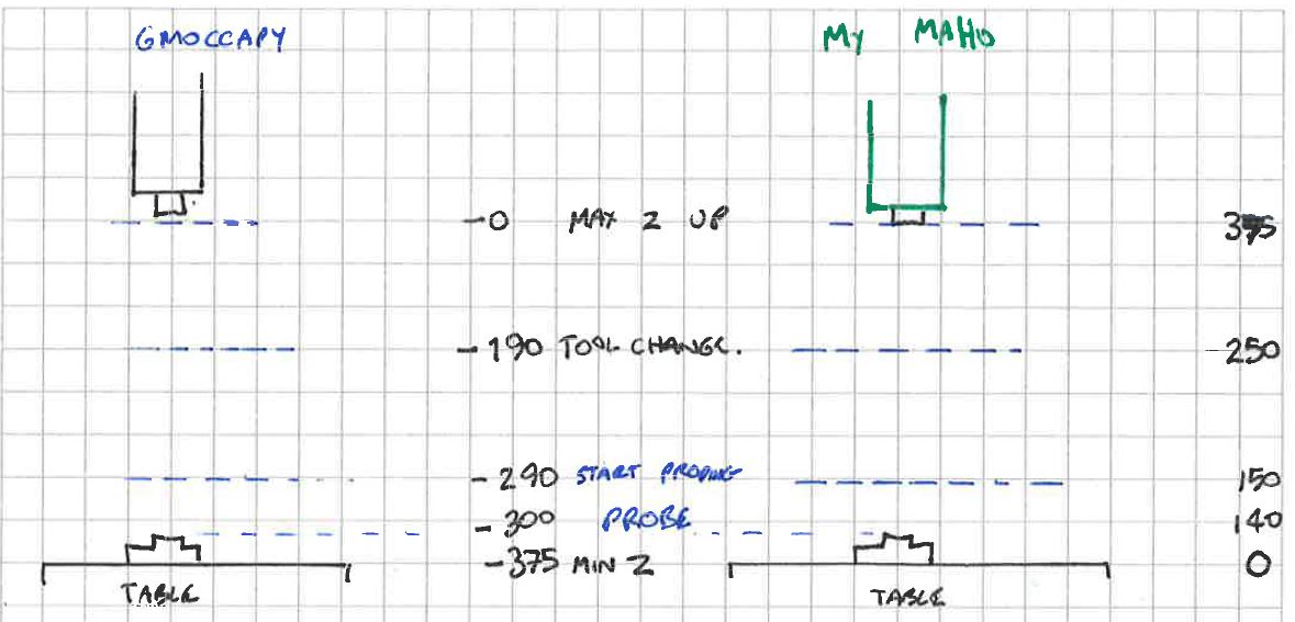

The MAHO has no home switches, it uses the index marks of the glass scale encoders for homing. It is a stationary head with a moving table, so here is here is a the layout showing table position...
___ -1 upper limit switch
--- 0 software upper limit
--- 140 Tool length sensor.(this is just a number I threw in for testing)
--- 250 tool change position (this is just a number I threw in for testing)
--- 370 home position
--- 375 software lower limit
___ 376 lower limit switch
The initial retract up to the Z250 worked fine (I havent tested what happens if the machine is already at Z>250.) It is the rapid from 250 toward the probe where it fails to stop at 140 and start the slow probe motion.

06 Jan 2020 03:22 #154134
by newbynobi
Replied by newbynobi on topic Setup results in error "Named parameter #<_ini[change_position]z>not defined"
Hallo Mark,
Toolchange Position must be in absolute coordinates!
Normally that would mean that the Z Position would have a negative value, as spindle all up is zero and going downwards is negative direction.
Change the DRO to display absolute coordinates (normally blue background) and move the machine to the toolchange position, what does the DRO show? Now move to the tool sensor and give also that coordinates.
Does this help?
Norbert
Does this help?
Norbert

08 Jan 2020 06:41 #154304
by RotarySMP
Replied by RotarySMP on topic Setup results in error "Named parameter #<_ini[change_position]z>not defined"
Hello Norbert, Thanks for taking a look at this.
If I understand correctly, it is normal to set up a CNC machine which ABS Z=0 at the top of travel and all movement negative. (LH Picture). Is that a standard convention for CNC? Should I alter my machine INI?
I have top of travel Z=375, with bottom of travel Z=0, so downward movement is still in the negative direction. To my mind this should make no difference. My machine is just offset by 375 relative to the norm.
With my INI (The full INI and configuration are in post #153283 of this thread) :
[CHANGE_POSITION]
X = 46
Y = 100
Z = 250
[TOOLSENSOR]
X = 46
Y = 100
Z = 140
MAXPROBE= -10
An M6 Txxx command first rapids in Z to Z[ABS] = 250, then rapids to X[ABS]= 46, Y[ABS] = 100, (The tool change position, where it diplayed the absolute positions of
X=46
Y=100,
Z=250 .
It immediately rapids down, but fails to slow down at Z[ABS]= 140 or perform the probing feedrate move down 10mm. I have to E-stop it.
[CHANGE_POSITION]
X = 46
Y = 100
Z = 250
[TOOLSENSOR]
X = 46
Y = 100
Z = 140
MAXPROBE= -10
X=46
Y=100,
Z=250 .
If I jog it to the tool change position, it displays:
X = 46
Y= 100
Z = 131,323 when the sensor switches.
Would it help if I made a short video showing the behaviour?
Mark

08 Jan 2020 08:42 #154311
Replied by Todd Zuercher on topic Setup results in error "Named parameter #<_ini[change_position]z>not defined"
While setting up your machine that way will work. There is at least one gotcha you will need to watch out for. And that is, most CAM software will assume that machine Z0 will be a safe position for rapid positioning moves in the other axis and will often call for moving there at the start or end of a file and at tool changes. How your machine coordinates are laid out should not matter otherwise, since the g-code you run will ordinarily be using a work space coordinate system, and that can have it's zero point set where ever you like, usually either at the parts top or bottom.
If you think about it it makes more sense from a generic machine view point to have Z0 at the top of travel. If you are trying to create a convention that works on all machines z0 at the top works on and would be the same for most any machine no matter it's length of Z travel.

Thanks Todd and Norbert for pointing out that this is a normal convention. I can easily change this in the INI, but that alone wont solve the issue of the tool probing move rapiding straight through the assigned level.

Tonight I modified the INI to reflect Norbert and Todds advice. Zmax is Z[abs]=0 and Zmin is now Z[abs]=-375.
The behaviour has improved, in that it is no longer trying to ram the spindle through the table, but is still creating an error.
I made a short movie to hopefully make the issue clearer, and would appreciate help in addressing the remaining error:
