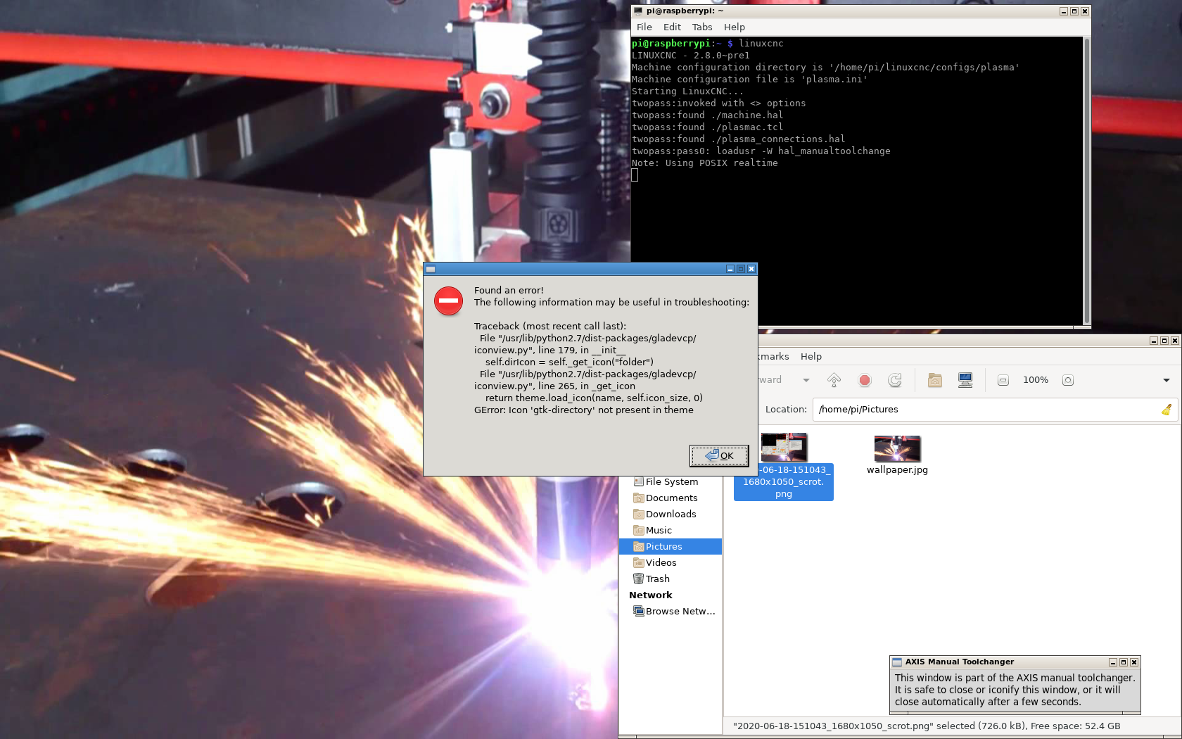

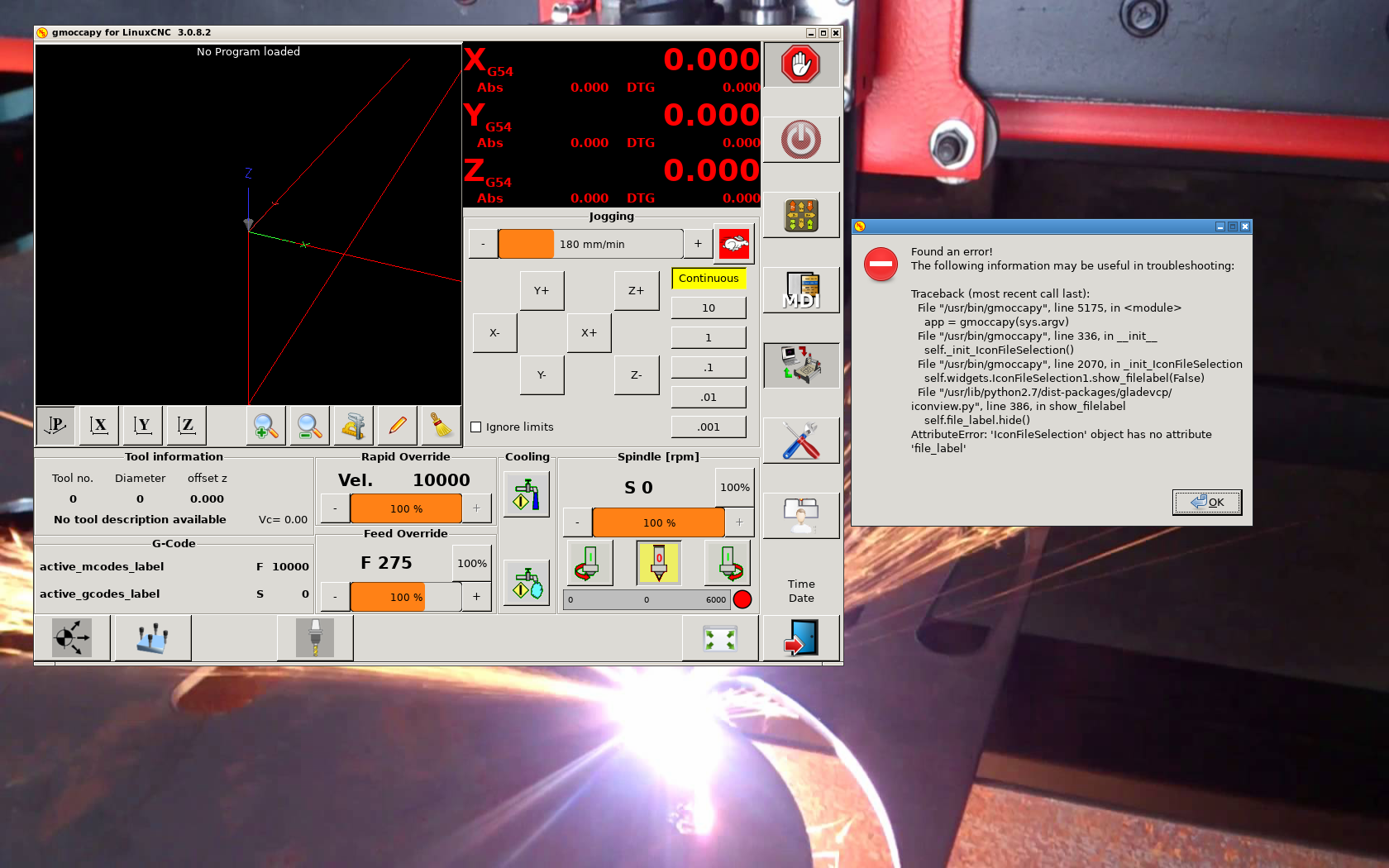

Hello everyone, i am Panos from Greece. I am new at linux in general and ofc i have some problems.
I have raspberry pi4 and install buster version with openbox, linuxcnc and real time kernel. I think that all good with that.
Linux raspberrypi 4.19.71-rt24-v7l+ #1 SMP PREEMPT RT Fri Jun 12 00:29:41 EEST 2020 armv7l
AXIS gui run ok but if i change to gmpccapy i have the errors as in screenshots and in txt file i have the terminal output.
I like more this gui and i would love to use it with my plasma, if is possible.
If you need more info about something i will be happy to provide it..
If you can guide me to the right direction to solve it i will be appreciate it, thanks a lot.

I find it out finally, the problem was that i didn't have a "desktop environment". I install one and open right away..
I use
I use
sudo apt install xfce4 xfce4-terminal

Replied by tommylight on topic Problem starting gmoccapy
That is strange, but since it was most probably developed under XFCE, there just might be something there.
Thanks for reporting back.
