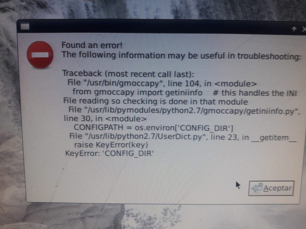

When I start linuxcnc, using the gmoccapy GUI, I get this error. the machine executes all the orders but does not show the value of the advances. (F 0)

How are you starting linuxcnc?
How did you get linuxcnc?
what version are you using?
sorry if i don't understand the question well
linuxcnc runs at Debian startup, configure: System > Preferences > Sessions > Startup Applications
linuxcnc /home/mill/linuxcnc/config/mill/mill.ini
linuxcnc.org - official installer - Debian 7 Wheezy
2.7.14
2.7.14
- Posts: 7368
- Thank you received: 2181
29 Jul 2020 15:04 #176404
Replied by cmorley on topic error starting linuxcnc.
Does it give an error if you start it from the terminal?
by typing:
linuxcnc
by typing:
linuxcnc
