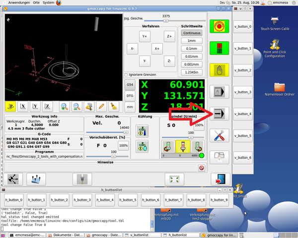

OK here is kind of where I am currently at. I have Linuxcnc 2.8 installed. Using a parallel port out to a Gecko540 to a Grizzly mill. I am as new to this as you can get so be gentle
. Anyway I have the gmoccapy interface up and kind of going. I can jog machine around and I have been able to manually edit my.ini file to calibrate machine and compensate for backlash on all three axis. So I feel like I have made leaps and bounds in a few days.
Anyway here is the dumb question I do not see anywhere on the interface a place to click and load a file ?? I know I am missing something here. point me in the right direction.
Thanks !!
Thanks !!

E-stop, enable the machine, home all, set it to "Auto" mode and the "open file" button appears at the bottom.

Nrobert did a good job of hiding stuff and showing them only when needed, makes for a cleaner and more elegant look.
