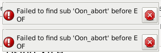

since I am in the final testing of my machine after I did the upgrade to 2.8 I have some minor things, which I can't solve.
If I abort a NC-Program (by pressing the red X button), I get the error "Failed to find sub 'Oon-abort' before EOF". This looks like an typo, but I can't find it....
Matthias

In .ini file, the entry should be as
[RS274NGC]
and 'on_abort.ngc' must be in the subroutine path
[RS274NGC]

my ini File
my on_abort.ngc
I just added a Button in MDI for the "on_abort" macro. It works as expected.
See my ini File attached.
my ini File
ON_ABORT_COMMAND=O<on_abort> callmy on_abort.ngc
O<on_abort> sub
G90
G40
G49
O<on_abort> endsub
%I just added a Button in MDI for the "on_abort" macro. It works as expected.

Does the macro work if you just enter the command in the MDI entry?
Norbert

Hello,
I had a similar problem, I had a% at the beginning and a% at the end in the main program. I deleted them and no more error messages.
