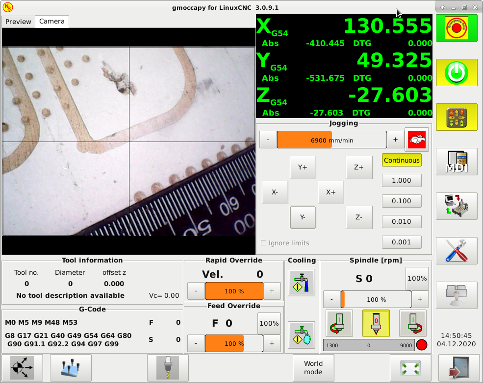

Since mplayer is no longer maintained and is replaced with mpv I thought I shared my settings to have a webcam shown in gmoccapy.
The syntax has changed a lot, but most things still work.
Using the proper camera name is crucial. You can get a list of all the video capable hardware if you do aYou can also find the proper name if you do awith unplugged camera and then plugin the camera and do another. Your camera will be the last hardware in the second list (or in the difference between the first and second dmesg).
For your information, these are pure cosmetic:adds a rectangle on the camera image in such a way that only the ' inner' lines show up.
same
The purpose of the rectangles (that form a cross on the image) is to have some crosshairs to better positon the spindle. The location of the crosshairs can be manipulated with the parameters in case your camera has an offset to the spindle axis.makes the cameraview in the tab in gmoccapy display without an ugly border.
There are many more command line parameters you can pass to mpv,Hope this helps.
EMBED_TAB_NAME = Camera
EMBED_TAB_COMMAND = mpv /dev/video0 --wid {XID} --vf-add=drawbox=-1:2:-1:240:t=1 --vf-add=drawbox=2:-1:320:-1:t=1 --no-borderUsing the proper camera name is crucial. You can get a list of all the video capable hardware if you do a
sudo ls -la /dev/video*dmesgdmesgFor your information, these are pure cosmetic:
--vf-add=drawbox=-1:2:-1:240:t=1--vf-add=drawbox=2:-1:320:-1:t=1The purpose of the rectangles (that form a cross on the image) is to have some crosshairs to better positon the spindle. The location of the crosshairs can be manipulated with the parameters in case your camera has an offset to the spindle axis.
--no-borderThere are many more command line parameters you can pass to mpv,
https://mpv.io/manual/stable/mpv.io
ffmpeg.org/ffmpeg-filters.html#drawbox
